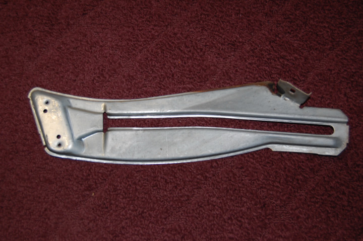

Take a good look at the guide rail (pic #1) that runs top to bottom. This holds it all together. It's held in place by a bracket at the bottom and the one at the top above the regulator.

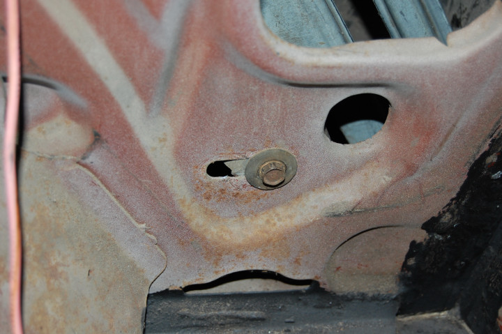

Remove the bottom bracket that holds the rail in place. You need to remove both parts, the part bolted to the interior panel and the one bolted to the guide rail. There's just not enough room in there unless you do. This bracket is used to adjust the top of the window in/out so it slides into the upper seal properly. You'll need to adjust it when you put it back in. The bolt that holds it to the body panel is shown in pic #2.

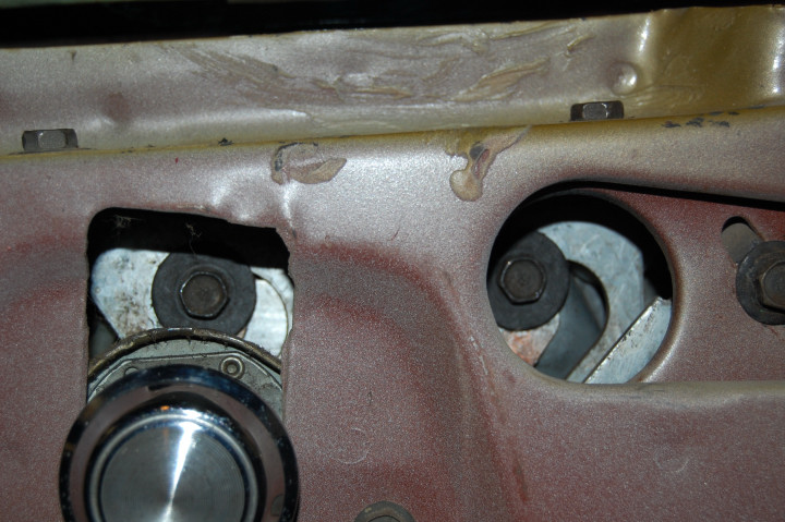

The top of the guide rail is bolted to an angle bracket. The two bolts that hold it to the bracket can be accessed from the inside just above the regulator, pic #3.. Hold on to the window when you remove these bolts so it doesn't drop to the bottom on its own. The lift arm will hold it some. Now remove the angle bracket, two bolts that come down from the top. Maybe you can leave it but it seemed to be in the way when I tried, not much room in there.

First pic is driver's side guide rail, top of rail on left. Fixed nylon guide on window, the one that does not turn slides down the center slot of guide rail from the top.
Second pic is bolt holding bottom of guide rail to panel. Slide this front or rear to align windows vertically.
Third pic is top guide rail adjusting bolts. Slide these front or rear to obtain proper gap between the windows.

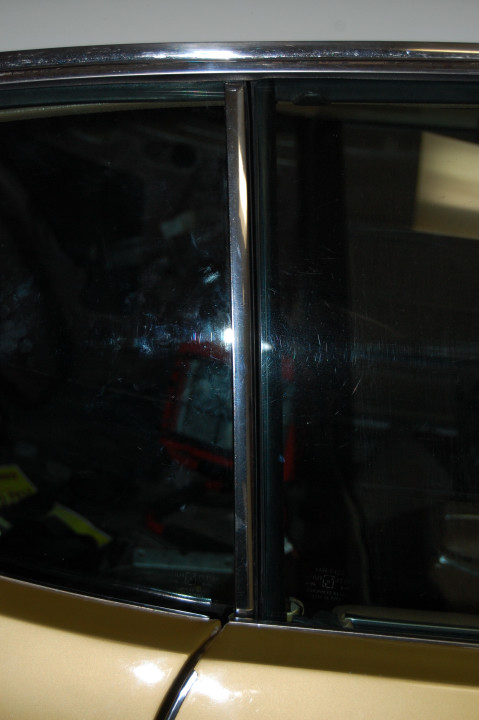

Fourth pic is the finished job. Well almost finished, need to get out the Windex and clean the windows. It's not the best pic but gap is uniform top to bottom.
