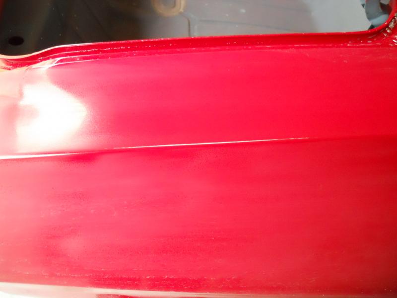

Thought i was doing good and wining the battle.
Then i did this on one of the places that the clear was a tad dry
with some 1500 wet sanding.
looks like im shooting some base again
then 800 wet the whole tub and a few more coats of clear
I could do a blend....but want it better than that.
