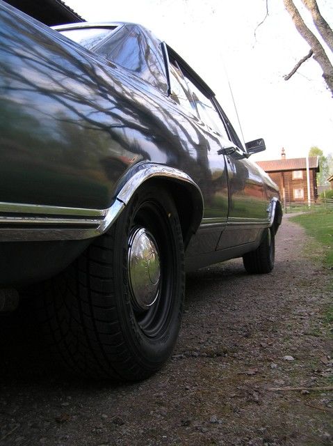

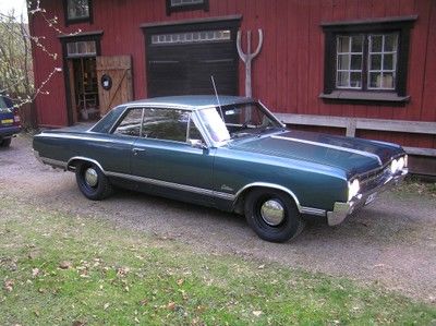

4.25 back space on a 8" wheel is not enough for a GM A body.. 5.25 is more like it.. The Cutlass in the photos has 15x8 with 5.5 back space.. 255/60r15 tires also..
I would use stock 15x7 rallys with 225/70r15 tires.. The stock wheels are hub centric..
