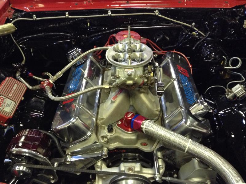

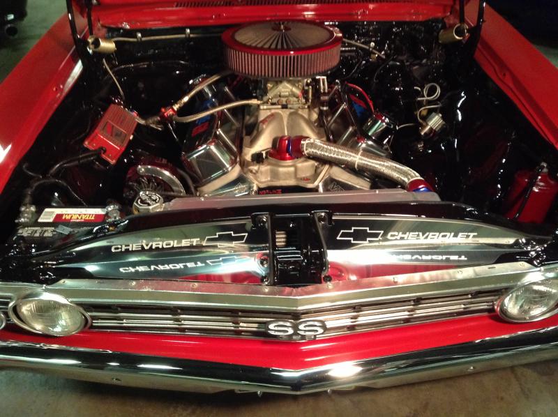

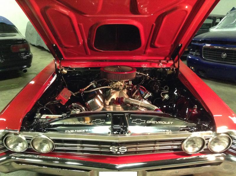

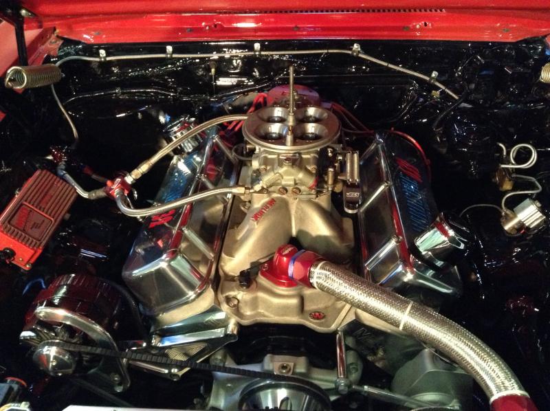

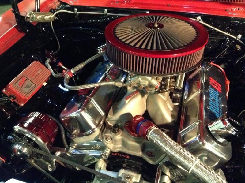

Post up some pics of your engine and underhood shots, provide some specs too !
A few pics of mine.....
Specs:
863 Horse Power, 800 plus ft lbs tq- All Motor, No Nitrous.
632 Cubic Inch Merlin III Tall Deck Block
Merlin III 350cc Aluminum Heads w/ 2.30 Intakes, 1.94 Exhaust Valves
10.5:1 Compression ( Run 50/50 mix of 93 & Cam 2 Race Fuel, just to be safe)
Solid Roller .700 plus lift
Merlin Intake
1150 Dominator Carb
Mallory HEI Distributor w/ MSD 6AL Box
Hooker Super Comp Headers ( soon to be Lemons Headers for better f it/finish )
3" exhaust with flowmaster original 40 series mufflers w/ turn downs ( going to 3.5" with new sgl chamber Flowmaster race mufflers )
Putting The Power To The Pavement:
400 Turbo- Full Comp Trans, Manual Valve Body, Trans Brake, External Cooler
3500 Converter
4 Link, w/ 9" Rear, Moser Axels, 4:11's
33x21.50x15 Mickey Thompsons on Weld Drag Lites.
67 SS Chevelle Pro Street
33x21.50x15 MT's On Welds
