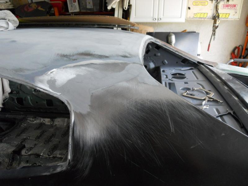

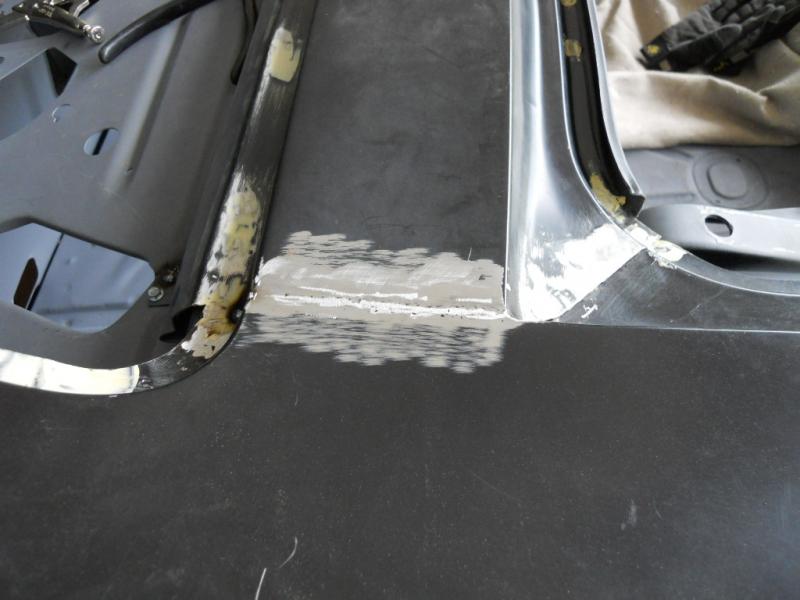

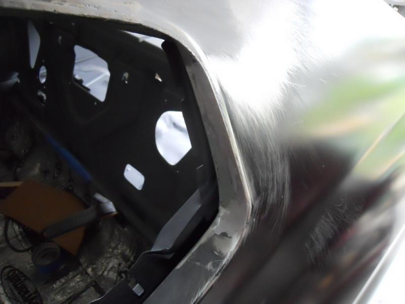

little more done today.
SMC metal filler on the roof to quarter gap after welding
ruffed in with 36 grit then some 80.
welded the filler panel to the quarter...(frowned upon by the purists)
And continued my quest for the shaved drip rail look.
