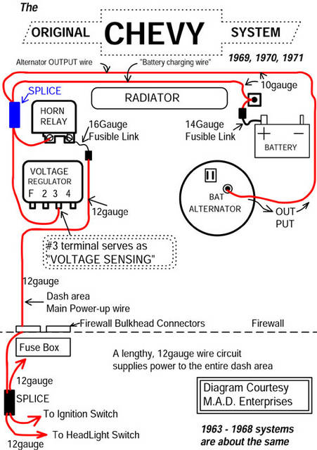

Yes there was a fusible link between battery and junction block. From there to horn relay, main splice, through another fusible link to bulkhead connector. All power except to starter motor runs through that wiring. Attached is a basic wiring diagram good for 64 through 70 Chevelle.
