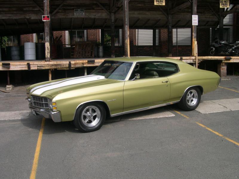

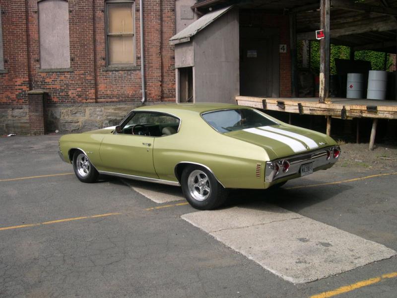

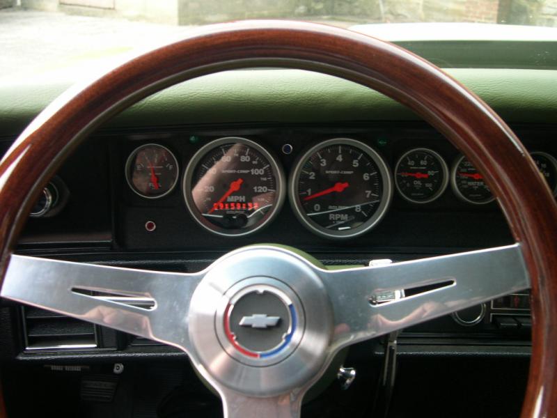

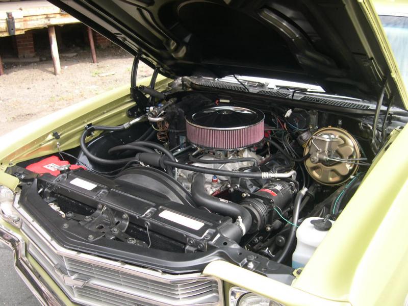

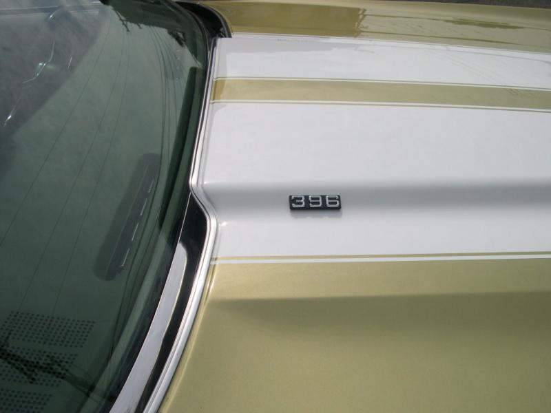

Haven't been on the website in quite some time. Since I finally got my car on the road in 2015 I have done a few more things to it. I ended up putting a GPS speedometer in it after the second speedometer cable ripped the stem of the speedometer off where the cable screws onto. I also put a new Autogear M22W in the car after the old 4 speed started leaking real bad. The PO had stripped 3 out of the 4 screws holding the front bearing retainer on and besides it leaking at the counter shaft hole it was really leaking at the retainer. I did a few other small items here and there but nothing really big. Added some 396 emblems to the Cowl Hood. Some new pics
