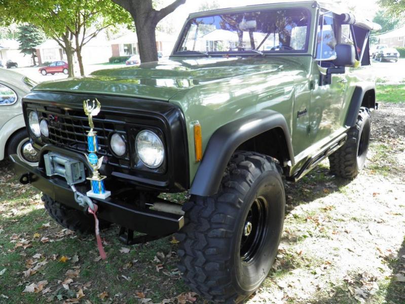

Welcome Hef. I wanna see a pic of the Jeep Scrambler. Hubby had a 1972 Jeep Commando until late last year. We all loved the Jeep.

That is a beauty of a Commando!!!! Toughest one I have ever seen and the first one that doesn't look like my grandpa should be doffing his hat from behind the wheel. NICE!!!

Here is a picture. I was intentionally looking for a Jeep with a carborated Chevy V8 because I want it to be able to take to the highway and be easy to find parts for. Having a 1971 Gen 1 (possibly out of a Chevelle) is just good to know and how I ended up here. I have been a big fan of Chevelle's all my life but Jeeps are so much easier to work on. Now I have a little of one and a lot of another. Not bad. My wife will only tolerate one play car a piece; other wise our driveway would have every stray I could lay my hands on. There is a 72 Chevelle convertible down the road that I keep my eye on. The couple do not drive it but will not sell it either.
Below are the pics...It needs a paint job and some tires but is a blast to drive.

That Scrambler looks very nice ,you just dont see many of those anymore ,at least around here .
