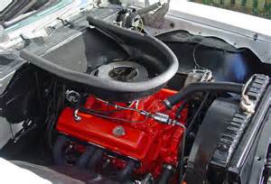

Cowl Induction hoods had the flapper. The hoods without the flapper are "domed" hoods. To make a domed hood function, you would have build an air pan.

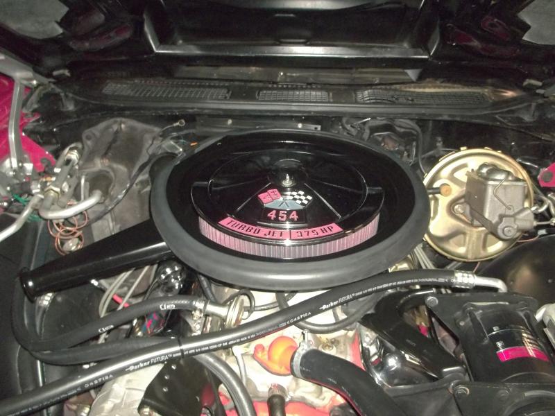

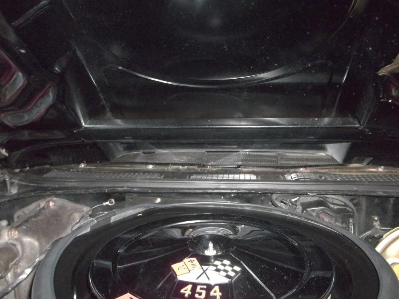

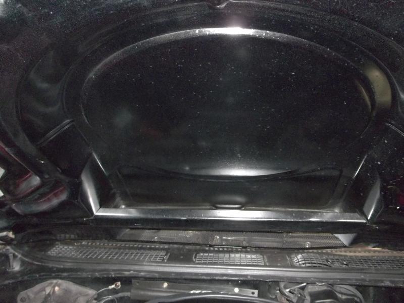

Got some shots but does not show much.

Old 09-19-2017, 05:38 PM
Well, hard to see. Does the circle in the dome of the hood open to the back near the windshield? The air cleaner assembly is definitely the same as used with a cowl hood and flapper.
Is that real L78 or L89 386?
Old 09-19-2017, 07:37 PM
Hank, I think you need to borrow Tony's glasses, the sticker on the air cleaner says 454.
Old 09-20-2017, 08:01 AM
Doh! All I saw was 375HP and was thinking L78, L89 396.

It does have a opening to the rear of hood but I can not see where the air would get in the breather unless it does not touch the hood.
Old 09-22-2017, 07:53 AM
The domed hood cars had a closed element air cleaner in 71'- 72'. I'll have look at the domed hood I have again. But, basically, if I recall correctly... you have to remove the screen and baffle from the rear of the hood.
