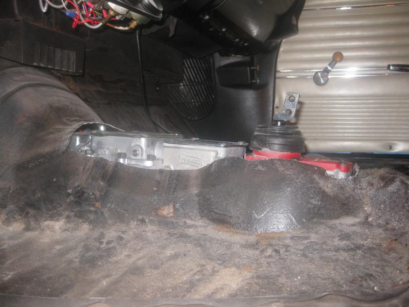

Here is what I have so far, the sawzaw went right through the sheet metal like butter....I'll have to do some massaging to the replacement metal they sent me as it does not cover what I had to cut. As you can see I still have some triming to do.

Look at the pictures he posted, he has at least 2 exhaust leaks at the headers. He has those tall ARP head bolts and they're probably keeping the header from seating properly.
