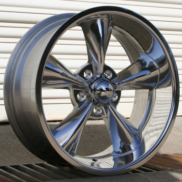

can i get a 20x10 wheel on the rear of my 72'monte carlo with out minitubing it.

IF Monte rear wheelwells have the same dimensions as 70-72 Chevelles, then yes they should fit with about 5.75" backspace.
Old 12-11-2012, 06:52 PM
From what I can see between my two cars, they are nearly identical. A piece of flat stock with some threaded rod will cost next to nothing and give you an exact idea of how much room you have to work with. hth

thanks,i'am going to buy one to try for fitment.

I'm wanting to go with 20s 10 on the back of my 67 chevelle and some 18s on the front. Do you guys know if the 20s will fit and whats the deepest dish I can have on them. I'll be getting the foose legends and I really don't know how to measure for offset. Thanks alot for any advice or links to websites that will steer me in the right direction.

I love the dish in the picture above and I really don't want to tub it. I don't mind rolling the lip some to get them to fit.

i went with 20x9 on the back and a 295 tire, i running air ride, 245 18 on the front ..no issues with the 9, but with a ride the 10 wont work without cutting the chassis and rolloing the lip
