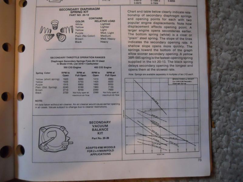

Default spring chart
Carb secondary spring chart in the 1985 holley parts book

when i was doing a little research i found this chart
and this one
but as of right now the purple spring seems to do the job right now. no gasp for air just nice and steady. I checked my uncles 350 and he also has the purple spring in place so i guess it does the right thing for the way we drive (really the way i drive my uncle drives like a whimp)...lol
