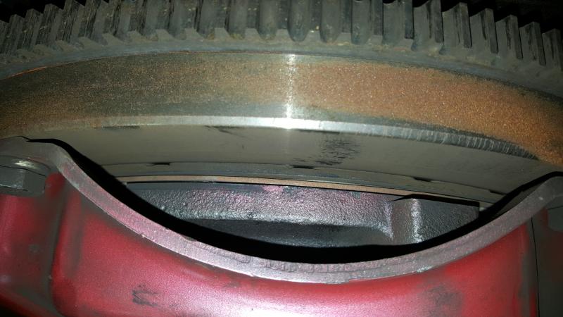

Lately, once in a while usually after I've been running for awhile, trans won't go into reverse, grinding. Pop it into first for a second and problem is gone. Yesterday did a 150mile run up to Maine, no troubles. When I headed home, trans didn't want to go into any gear easily. clutch pedal mashed to the floor. At one point, i could only start it in 1st with the clutch in. Checked fluid level, no issue. Checked clutch (picture) and there seems to be enough left. So I'm thinking this is a clutch pedal adjustment. Worried about why this happened after a long drive. I'm a newbie with this car and this m21 transmission. I'm I thinking right?
Thanks in advance for the help!!! Need to put more miles on this old girl over the weekend.
