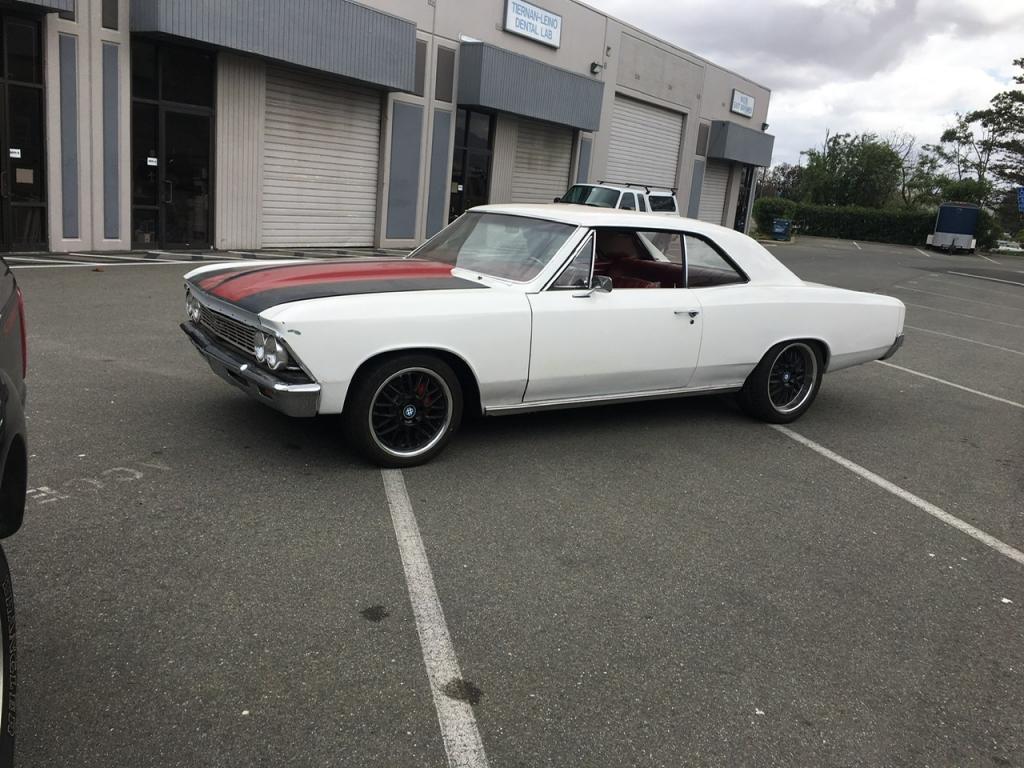

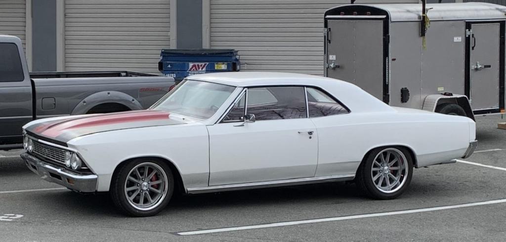

I had 17x8 and 18x9.5 Beyern wheels but recently switched to American Racing VN007 Rodder wheels in the same sizes. Same tires.
I’m probably going to change them again because the front rub the inside of the front fenders. The Wilwood disc brake extra width is the culprit and American Racing has such a poor selection of offsets i’m going to switch brands.
