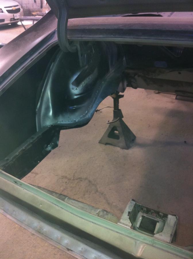

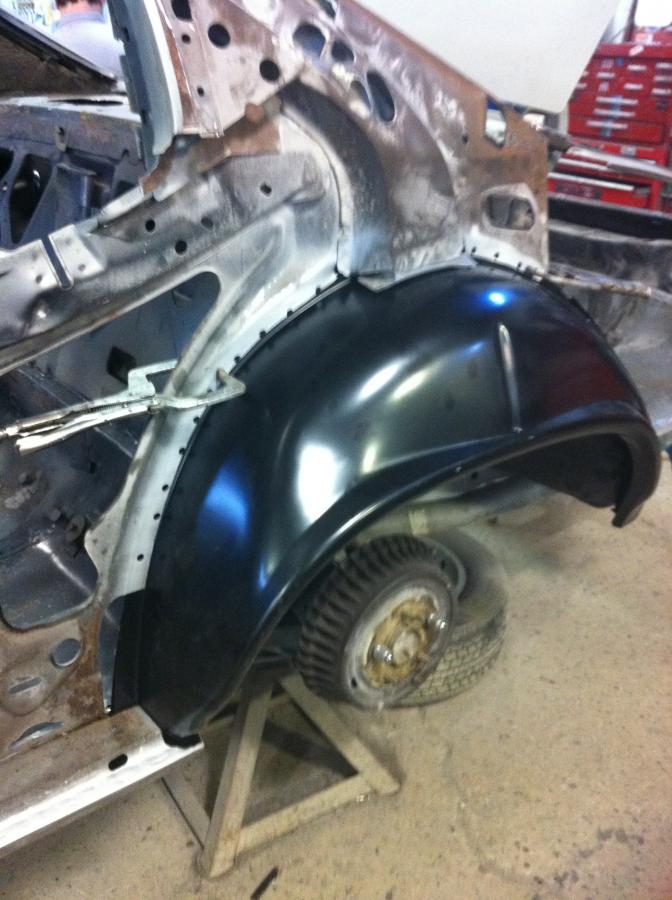

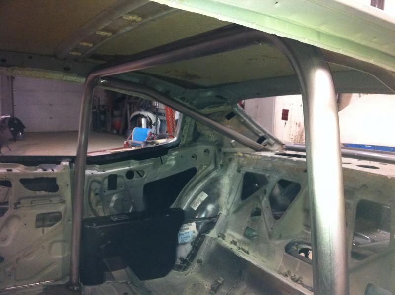

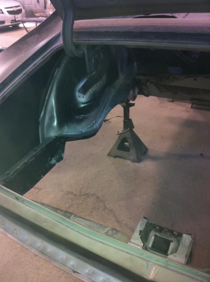

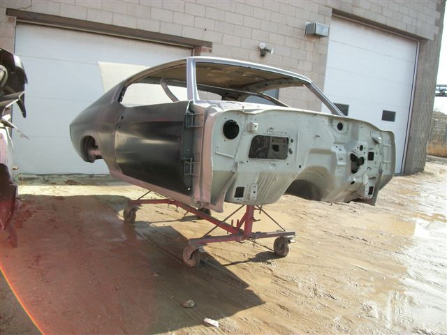

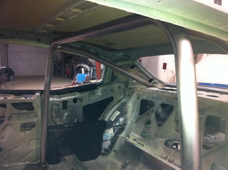

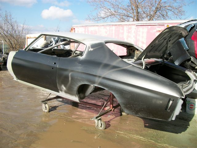

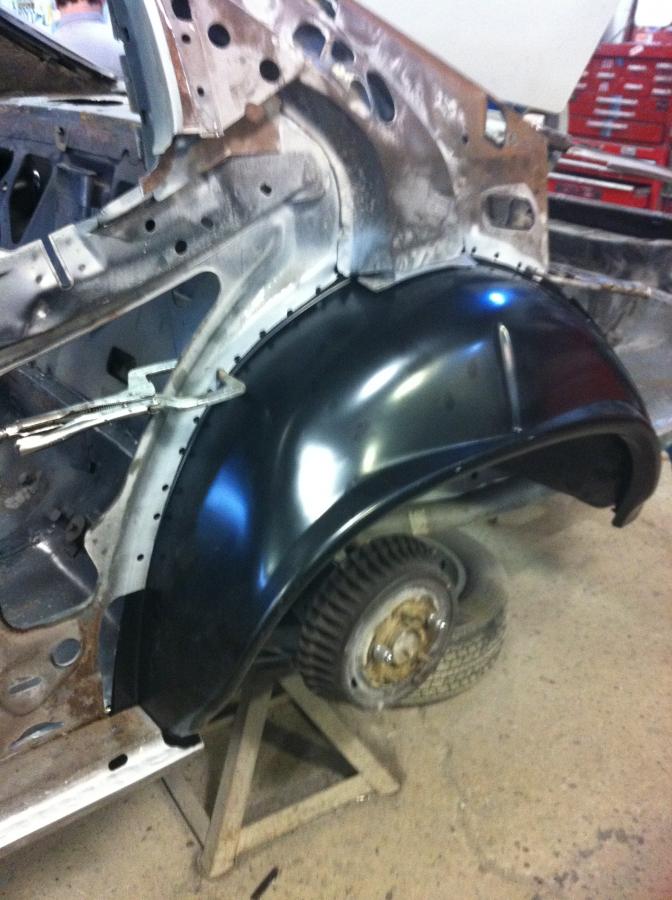

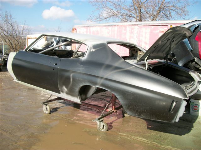

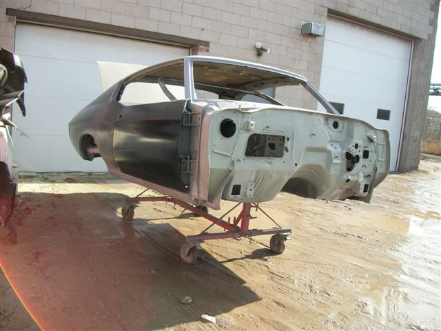

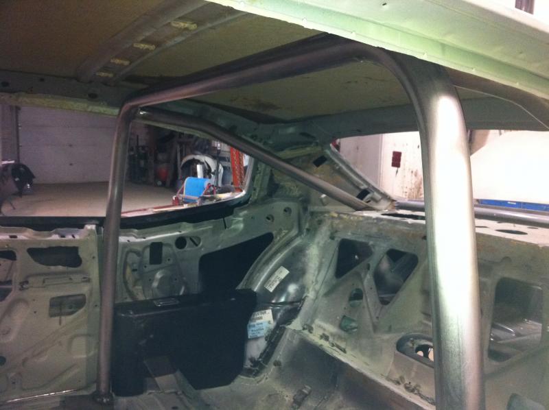

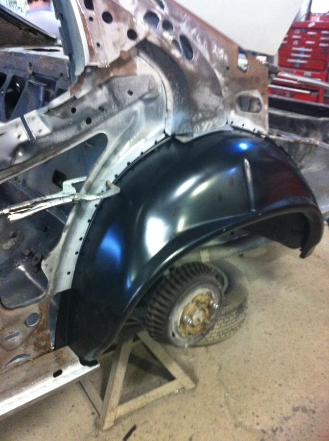

thanks ill post more pics soon.still have a ton of little things to finish,thanks
for all the complements.dont be shy to say if you like it or hate it.any info and
insite will be apricated.

I hope you put those quarters on while it was on the frame. Need to line everything up on the frame first before you put it on a dolly. Back half might line up but you need to check the gaps on the quarters and the front fenders on the frame before you paint it. You would be suprise how much changes once it's back on the frame.
