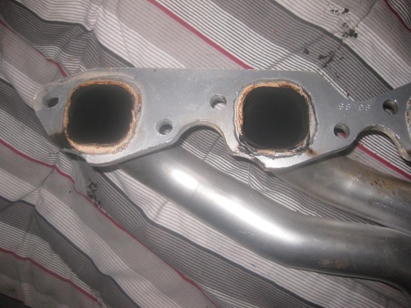

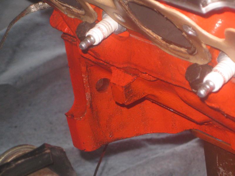

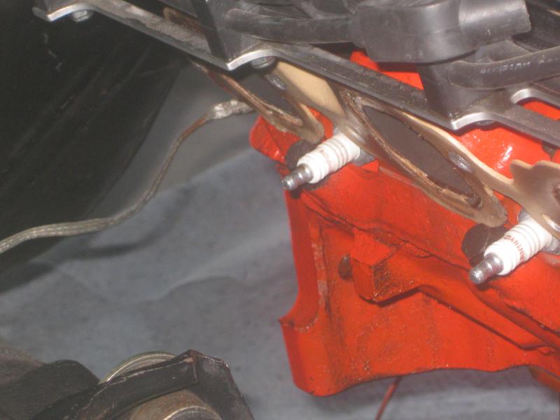

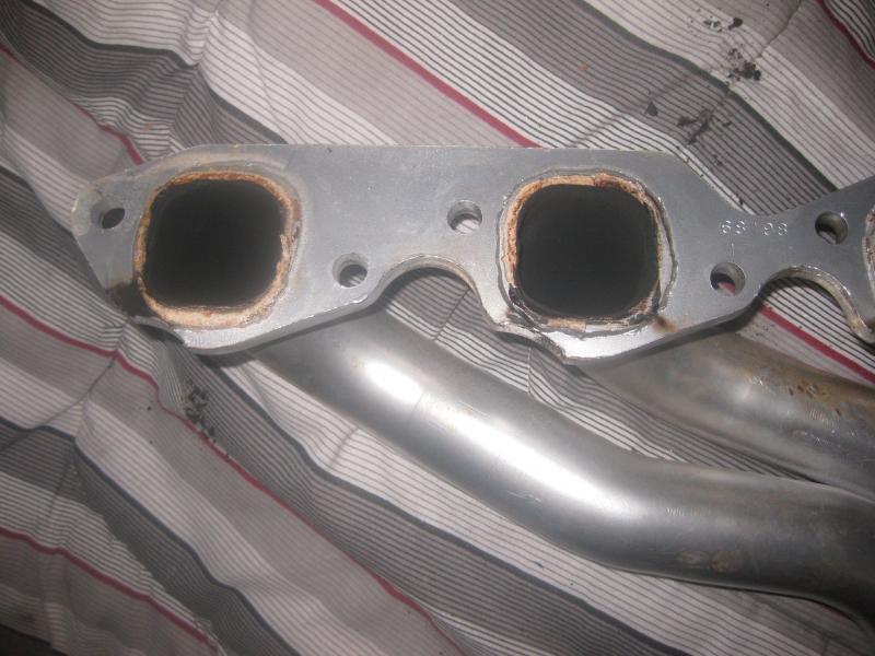

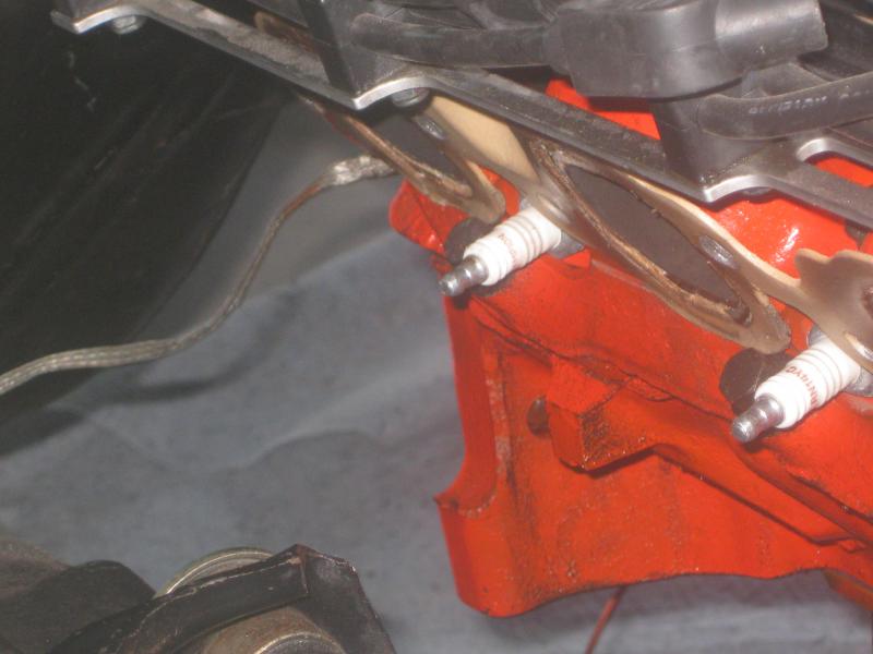

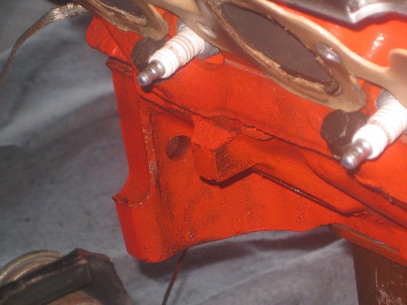

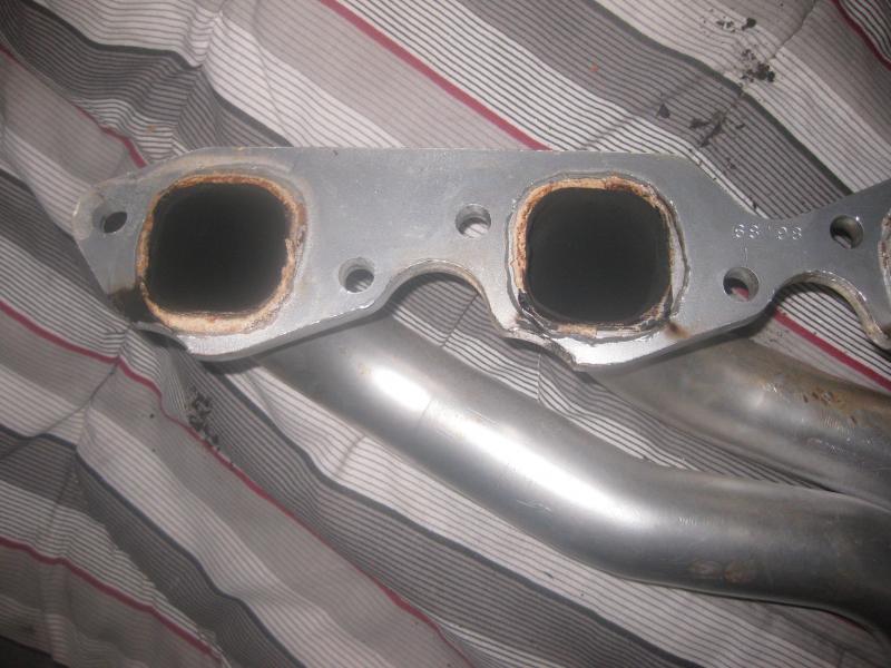

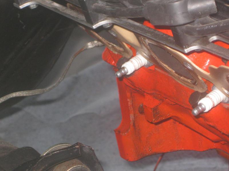

Well I got the starter and header removed and can see the back side of dowl pin but it still won't come out as I can't get a good swing at it...I'm going to see what is laying around work that woujld be better than a screw driver as the punch....and this is the easy side...the other side the oil filter boss is in the way.
When I pulled the heater off I see that it was leaking...any idea on how to stop it from leaking?

I see you have the tall ARP head bolts and the header has been ground out for clearance. You sure they're not hitting? The leaks look like they're right where the head bolts are. Maybe the gasket was pushed out of shape by the head bolt.
