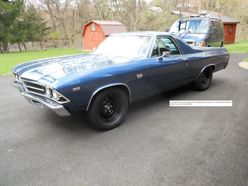

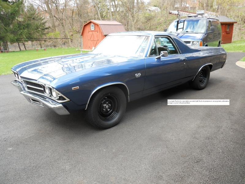

From what I gather, you want the wheel width the same or close to the tread width.. With 15 x 7 wheels, I mounted 255/60-15 and 275/60-15 tires just for kicks (photo).. The tires didn't grip worth a damn.. I switched to 225/70-15 tires on the same wheels and they grip much better..
I'm having Series 62 wheels made up , 15 x 8 with 5.5 backspace and I'm using Master Craft 245/60r15 tires.. I'm having the wheels painted the same color as the car with dog dish hub caps..
