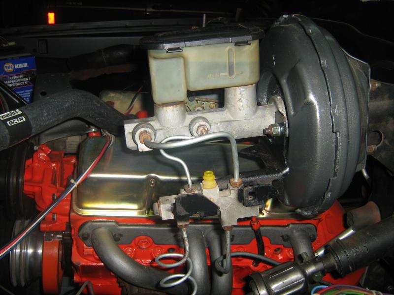

68 power booster with 93 master cyl,had to make an adjustable push rod,also used the 93 prop valve.truck stop perfect and with authority!
