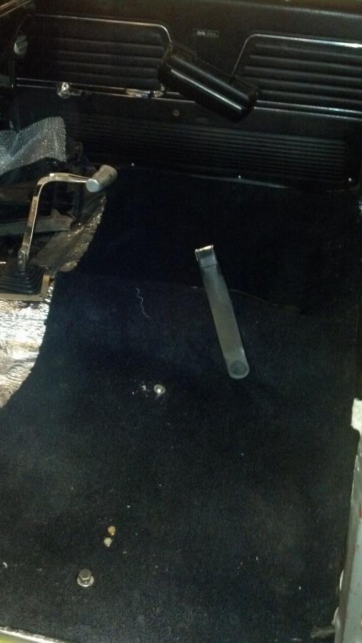

1 Attachment(s)
lol nope it didn't work...lol
well this is how far i got today and i am pretty happy with the chance to get to this point at least!!
http://chevelleforum.org/attachment....1&d=1389326568
tomorrow i am going to finish installing my front seatbelts and front seat belts i hope :)
