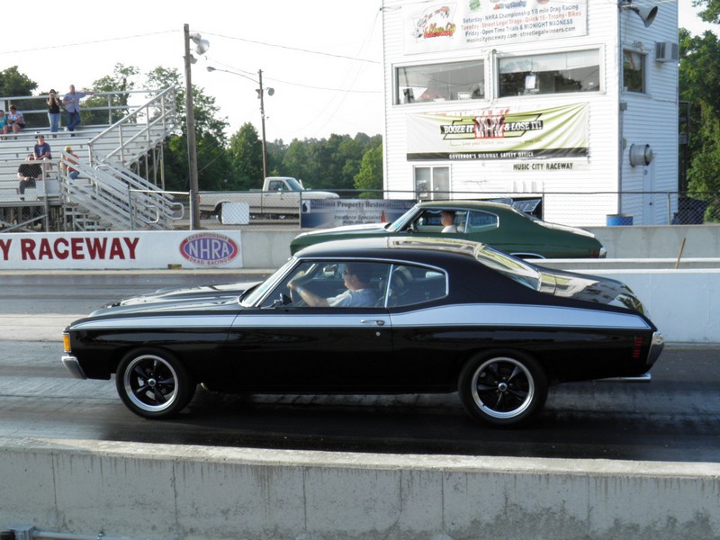

I have attached a picture for the look I am going for on my Malibu (someday mine will look just like this sweet ride:banana:)
69chevelless 10-02-2012 06:09 PM
Nice car, I like the colors. I had 335 70 14 on my car before but I switched to the 335 60 14 for a wider look. I don't really like the skinny tire look but I like the same all around.
