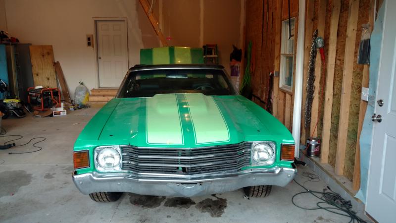

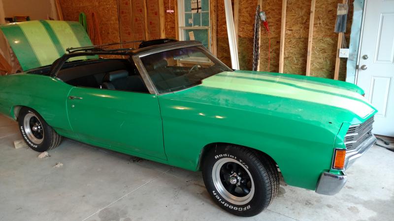

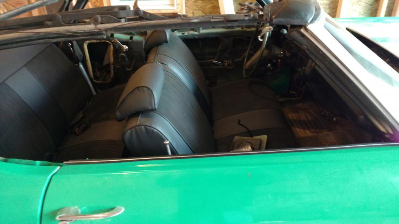

paulywood 06-09-2016 01:53 PM
Finally got it down to the upholsterer last night. The marble sized hail covering my deck Monday night scared me off. Took a few pictures of it before we left. It was an interesting ride since it is waaaaay out of alignment.
