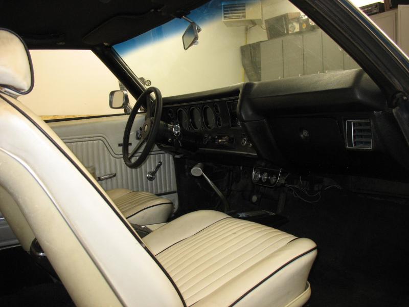

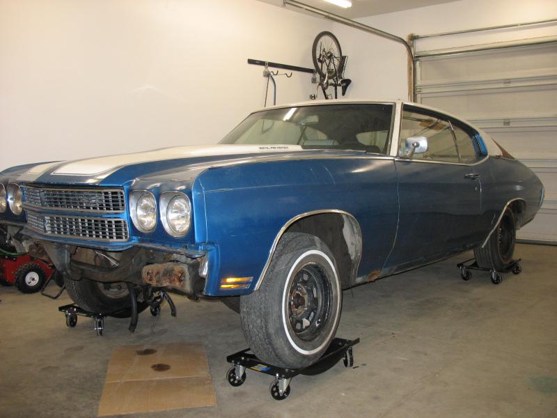

Here's what I started with. These are pre-box photos. It needs trunk pans, quarters, and front fender patches. The rest is pretty solid. The front clip is off and the interior is out now.

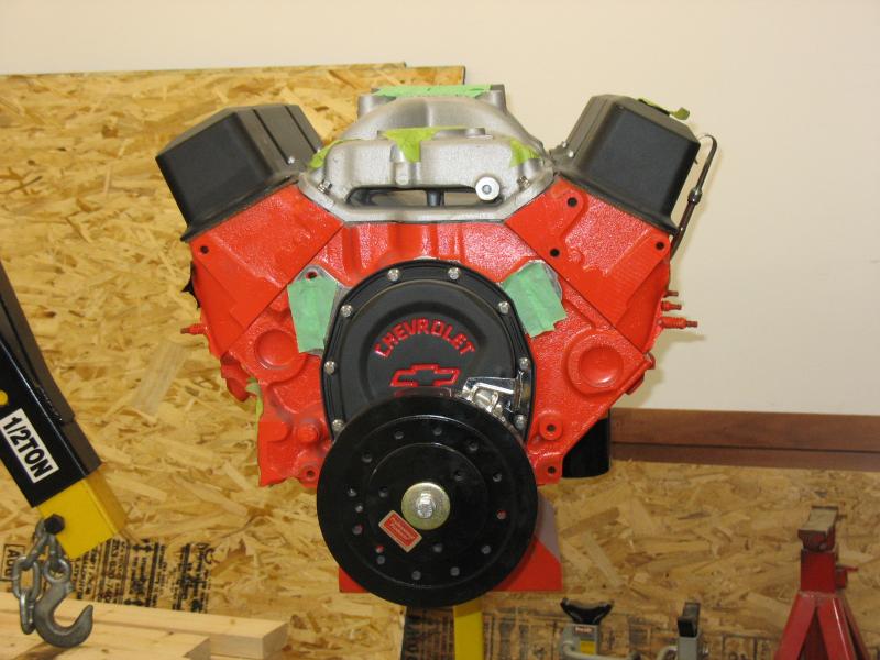

The motor is fresh, #'s 350 +0.040, flat top hypereutectics, Comp XE268 HFT, roller rockers, RPM Air gap, re-worked heads, etc. M20 is not #'s, 12 bolt posi is.
Ron
