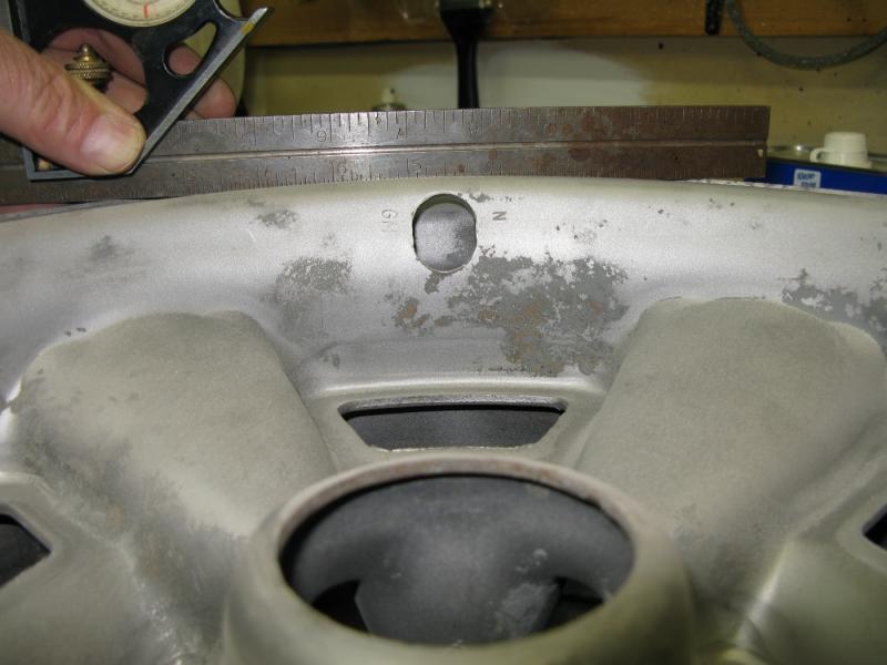

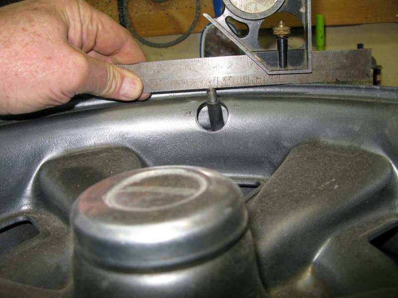

Here is a couple of pics. One is for a Camaro and the other is a 72 SS. The round valve stem hole is for the Camaro. The oval hole is for a Chevelle. You can notice the flatness in the spoke on the Camaro wheel. Plus the steel tire rim sits proud of the inner rim where the beauty rim attaches on the Camaro. Hope this helps.
