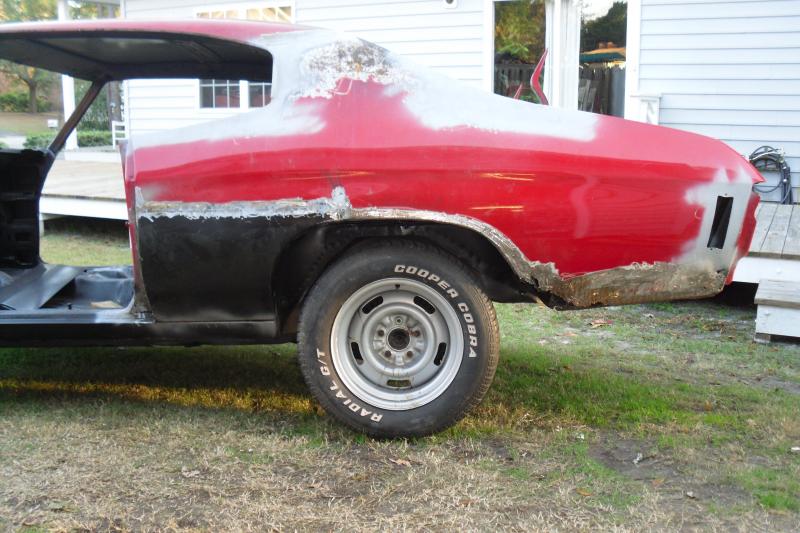

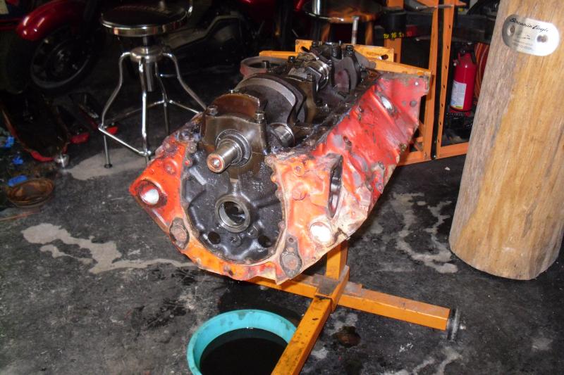

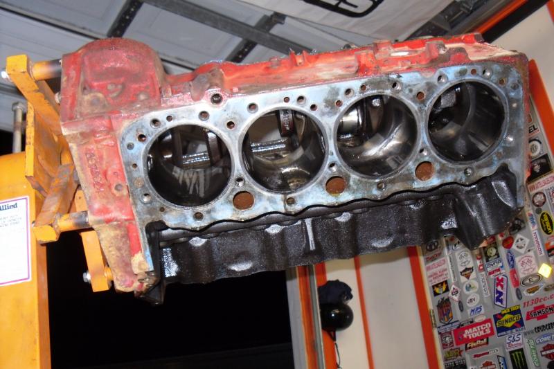

Tore down the motor over the week and brought the block,heads and crank to the machine shop. Going to bore/hone it. Hot tank the block and heads. New brass freeze plugs, cam bearings. And a valve job with new springs.

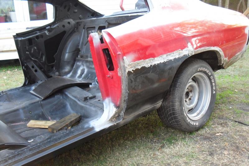

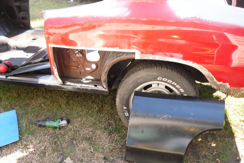

Started the left lower front quarter and have that finished. Going to move to the rear lower quarter in the morning.
I seen a sweet green early 70's Camaro. After seeing it I have been bouncing around the idea on going green with black stripes. Its got to be the right green. And I have to be able to get in in a single step paint. Still have lots of work before painting. But I do have to decide soon. Going to be jamming out the edges and around the glass before glass and doors go back in.
I HATE RUST!
