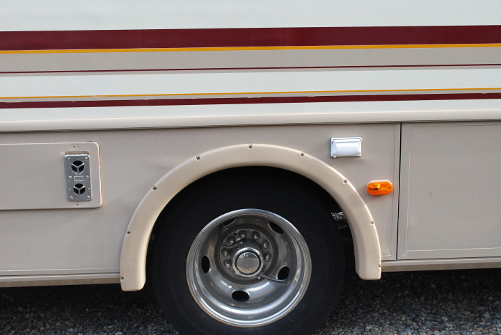

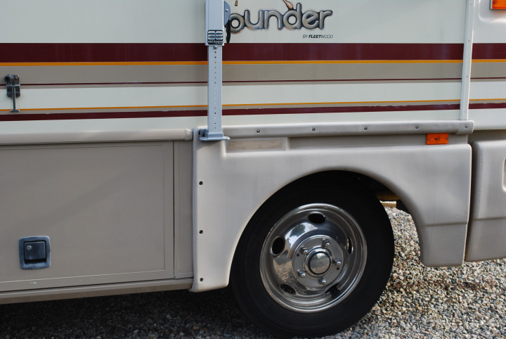

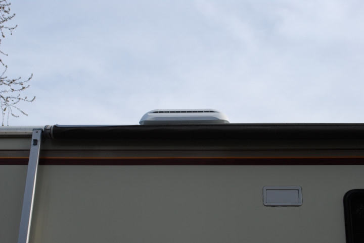

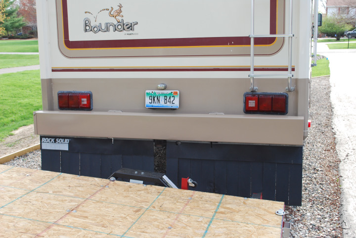

...being unemployed is too much work. The rear bumper on the motorhome was crunched in the middle, top and bottom were buckled. So i pulled it off, cut the back side open, beat it back into shape, welded the back on again then painted it. It's not perfect, that metal is a lot thicker than auto sheet metal but it looks better. Krylon Khaki is a pretty good color match, not perfect but close, first pic. So I got some Krylon Fusion in Khaki and painted the rear plastic fenders and one front fender, 2nd pic. You can see from the pic of the other front fender how dull and faded they were, 3rd pic. Also replaced the frig vent cover, the plastic was cracked and brittle, 4th pic
