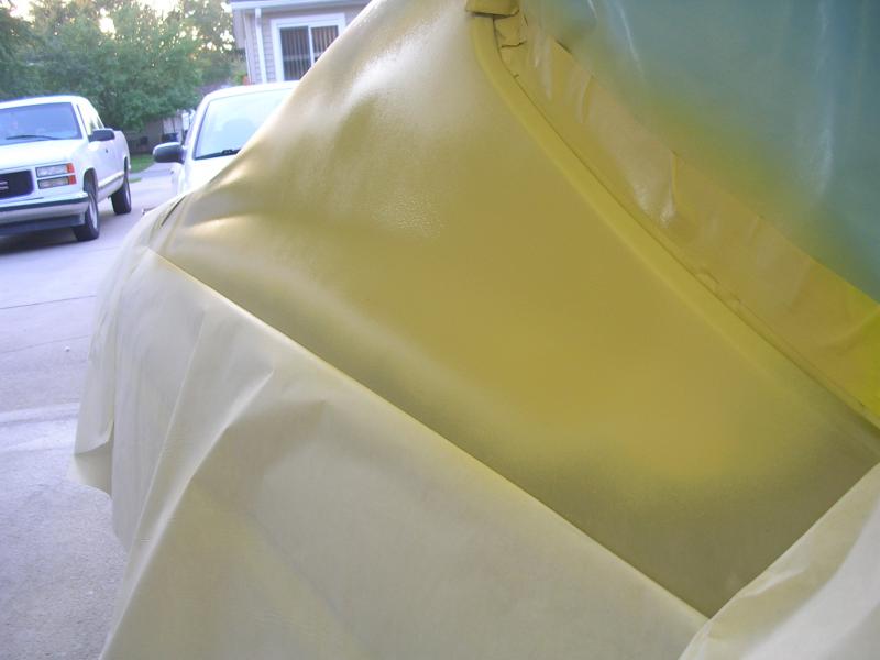

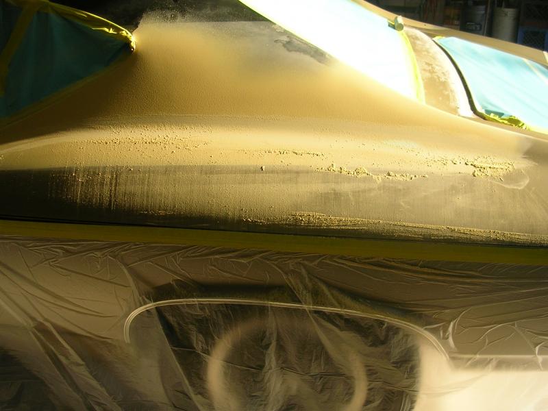

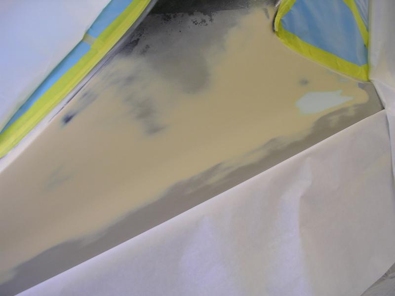

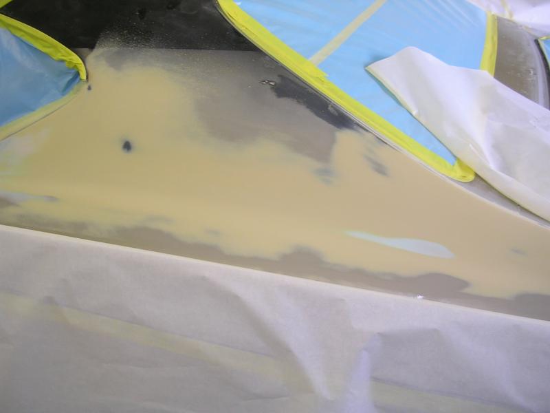

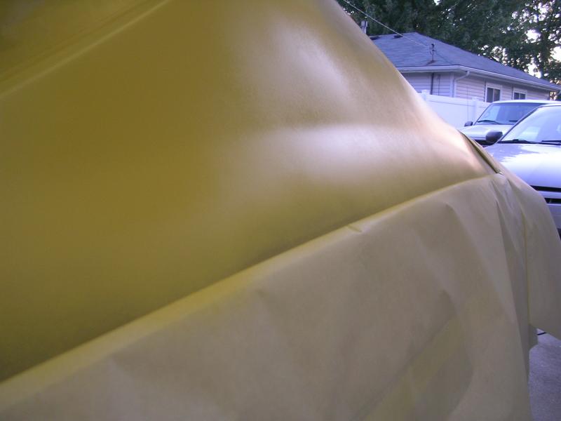

Today after work I blocked down the primer I applied yesterday,and I used 240 grit exclusively.You can see some areas where I did not get enough material off before it was primed.It's hard too judge when your dealing with repair area of these size's not to mention a gradual curve with a negative radius of this length....can be somewhat tricky
But it did turn out nice after one blocking. I put three more coats of primer on the area's with some extra reducer in the mix so it lays a bit flatter/smoother for easier final sanding before the topcoats. If things go well I should have the custom mixed paint tomorrow and possibly spray color/clear tomorrow night
Here's another round of shots.............
