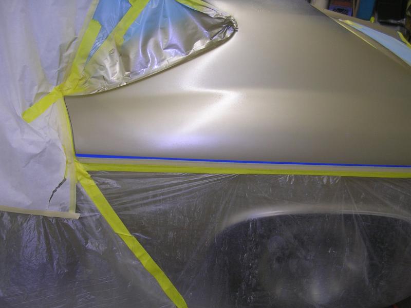

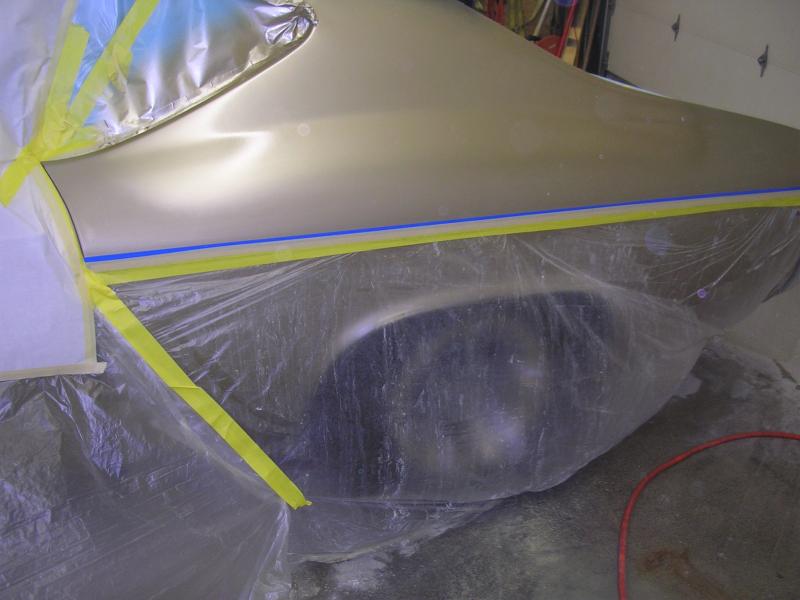

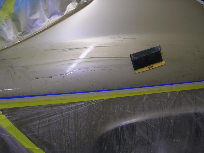

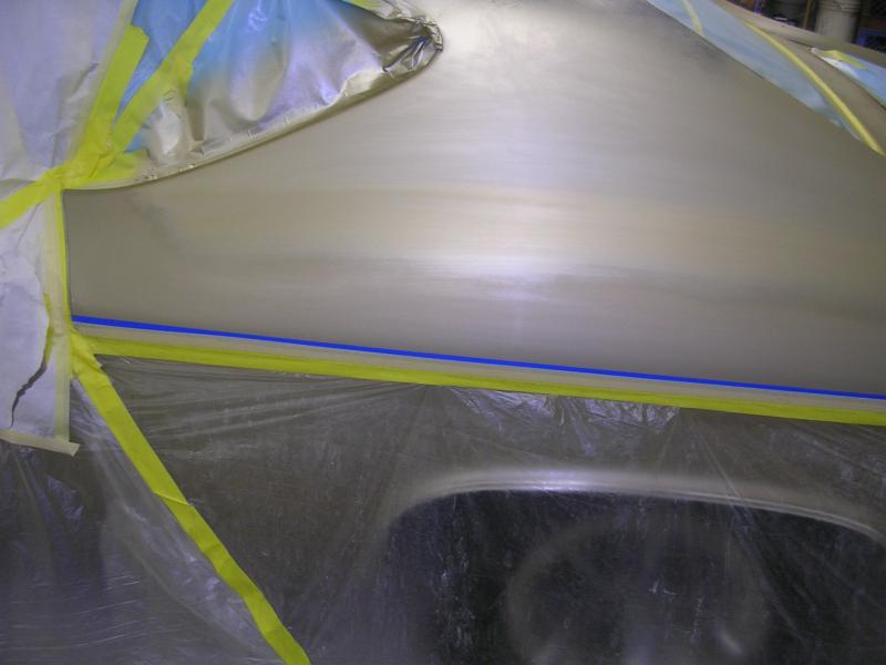

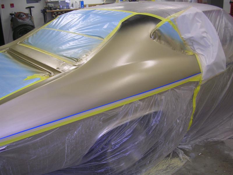

I don't have any sealer and frankly,I don't want to use it here cause we are to close to the doors.So what i did was to use the paint and apply two descent coats over the primer and allow that too dry and sand that down as to "seal" were the two different materials meet...If you don't do this you will see a funky line where they come together.
After this I apply another coat of the color and start to make judgement on the tint......it is too light !
