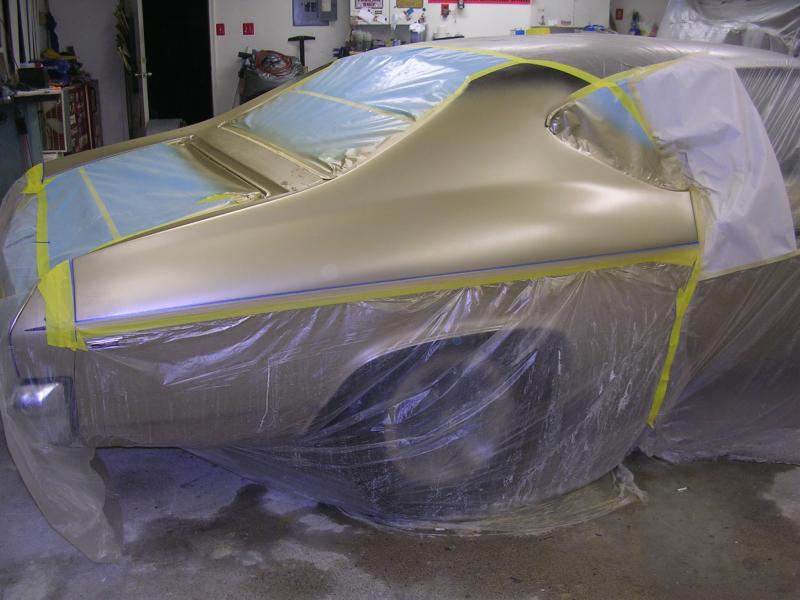

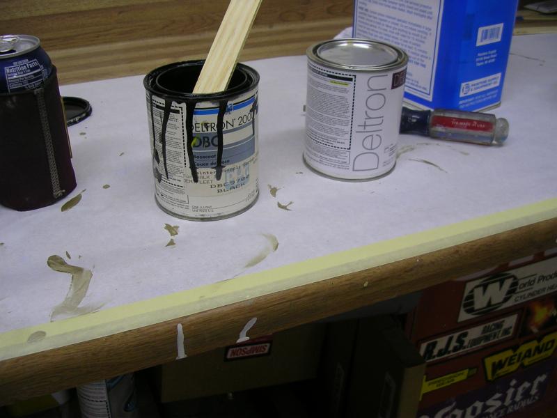

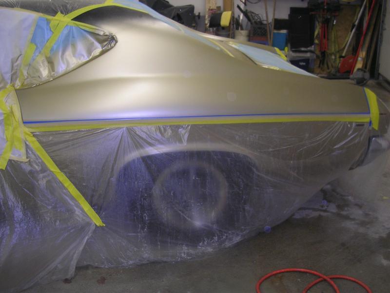

They supplied me with some silver tint but that would have gone the wrong direction so what i did was end dropping in about 10 drops of "black" paint into the mix to "dirty" it up which helped alot from what we had,definately a step in the right direction. After spending some time at the edges of the blends ,it's time for clear.......
