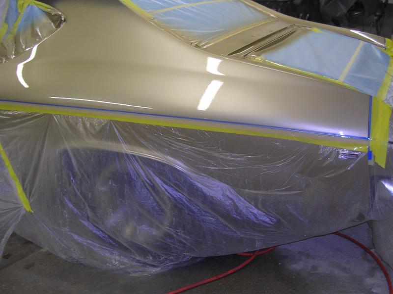

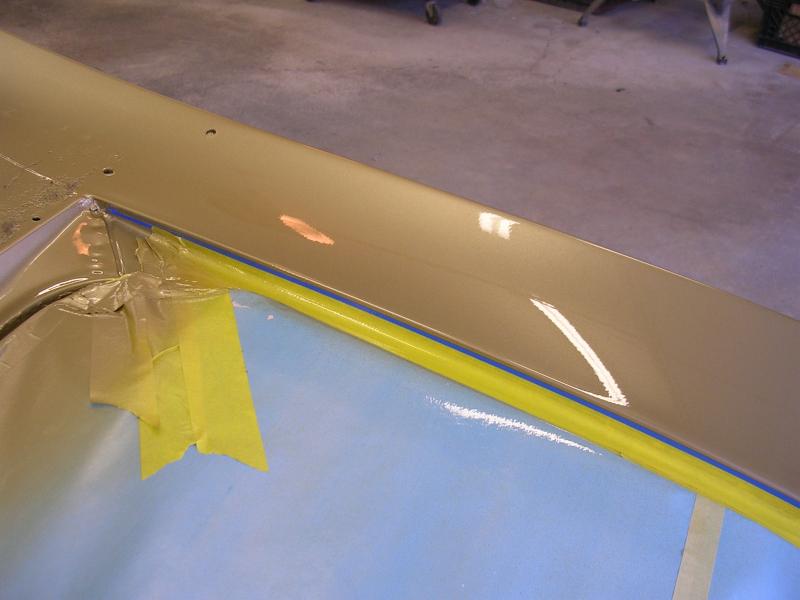

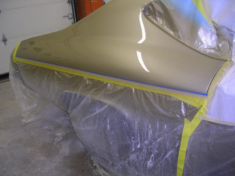

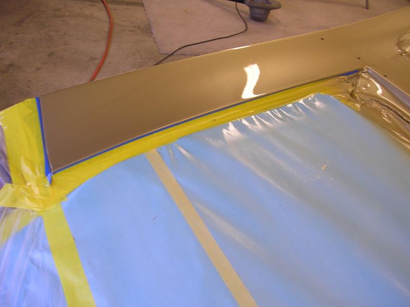

Now from these shots with the clear you can see how i tried to stay away from the stripe,the front and rear of the panels, and away from the decklid on the tops of the 1/4 panels....very tedious stuff let me tell ya !! This color is very difficult.....In fact the mix we have is not a perfect match by any means but the way it's blended makes it presentable and thats what we're after here. Absolute perfection would be too respray the whole car and thats not going to happen.
