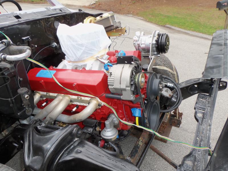

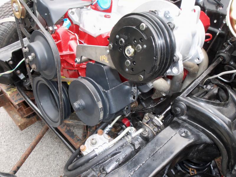

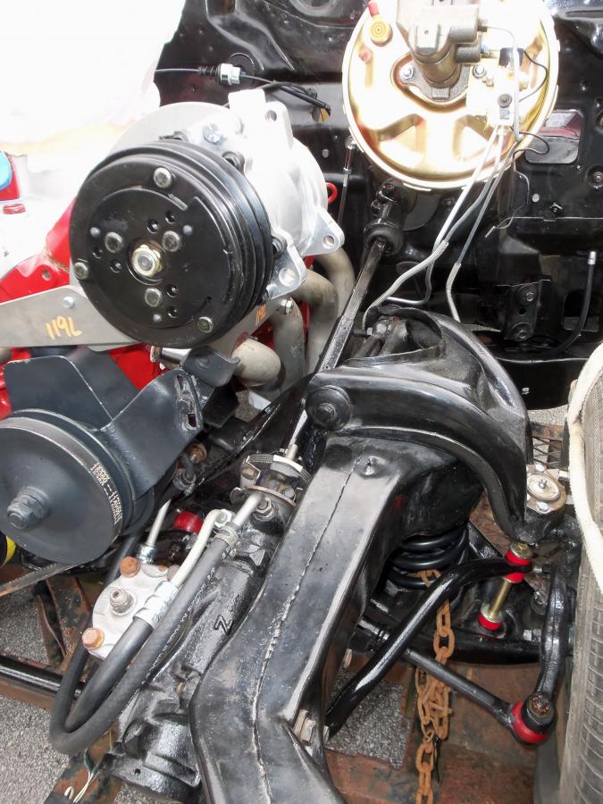

The Jeep steering box swap went very smooth. I ordered the ragjoint and the little parts you instsall in the box for the stock lines to work with from Lee manf. The stock lines on my 72 didnt quite look/run to good. The bend were it conects to the box was funky. I purchased a new high pressure line for a 68 and it has a nice 90 degree bend at the steer box. The low pressure was much closer and could be bent to work. Now the lines coming out of the box are much neater and look factory to me. Take a look in the photos.
