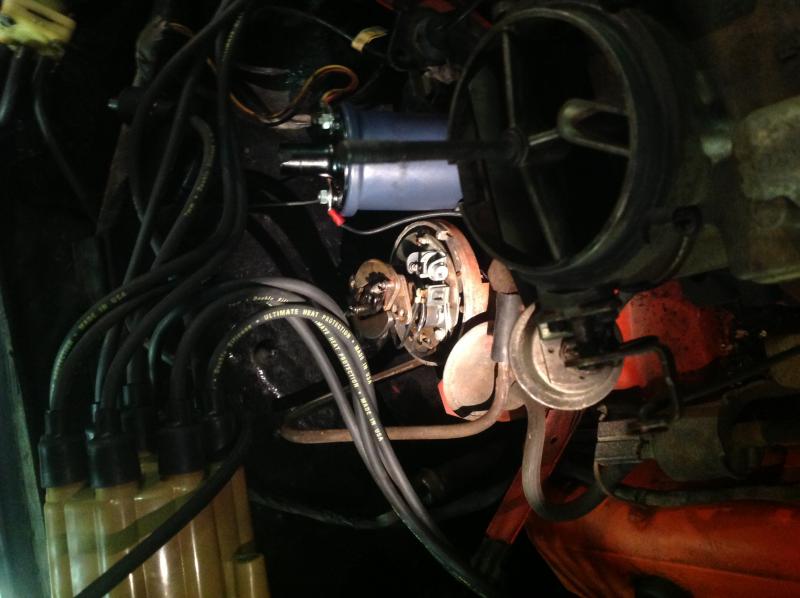

Thanks for the welcoming guys. Yea I'm gonna try and join that club it didn't wanna let me sign up yesterday but I'm gonna try again on my laptop not iPad tonight. Anyways so I had my neighbor (he's very old and it's been 26 years since he's worked on a classic car) help me today, we hooked his remote start up and it didn't want to work for Some reason. Not sure why but we were both there so we forgot about it and just did turn key. Soo we cleaned the points with a fine file he said since it ran when we put it away the dwell should not have been set off. Wile we were cleaning and turned the motor over he noticed play in the distributor. He said more than he's ever seen, and said this could set the dwell off. I happened to find a new point laying around my dad bought years ago ( just to let you know my dad pasted multiple years back and is the reason nothing runs) so were planning on putting it on tomarow. If this doesn't make it spark and we do have a dwell meter and everything is set correctly and it doesn't start it must be my distributor right. When I say this I mean bearings must be bad and while the motor is turning there to much slack and its setting the dwell off. Correct me if I'm wrong because I might not have my facts streight. Thanks ms grumpy and grey for the welcome and help. Ill try and upload some pics.
