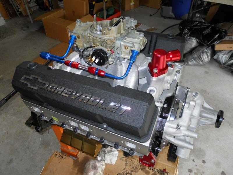

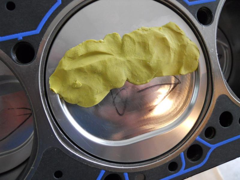

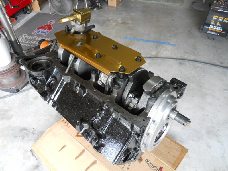

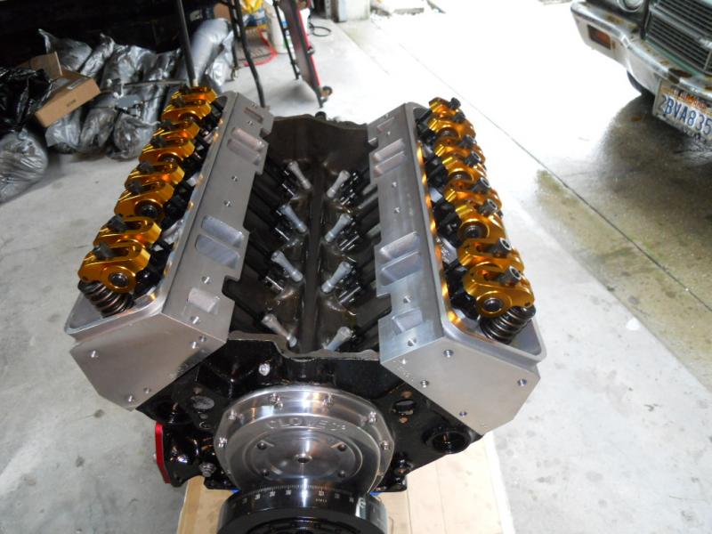

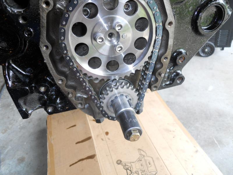

thought id post up some pics of the new mill.
ive been carting the short block around since 2002.
finaly got it finished.
its not a race engine...but should make power.
40 over 4 bolt block...2 inch block fill
scat crank 3.75 stroke..6 in h beam rods..srp pistons
comp solid roller set up...230 236 at 050
dart pro1 200 cc heads...rpm air gap.
