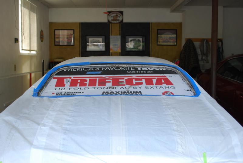

Got my rear window installed, what do you think? The old one was clear and let in too much sunlight. This one definitely blocks a lot more sunlight.
Started cleaning out the pinch weld today. Cardboard will hopefully keep some of the crap out of car. A brass wire wheel to remove the urethane, butyl, and mystery goop I couldn't scrap and cut out. Spot blaster to remove the rust Not too much, lower corners as expected. Didn't get the rear finished today, close to 90* this afternoon. Once the sun moved past the shed and I was in the sun I quit. Don't really want to blast that crap out inside the garage. I'll have to start early tomorrow to take advantage of the shade. Then on to the front windshield.
