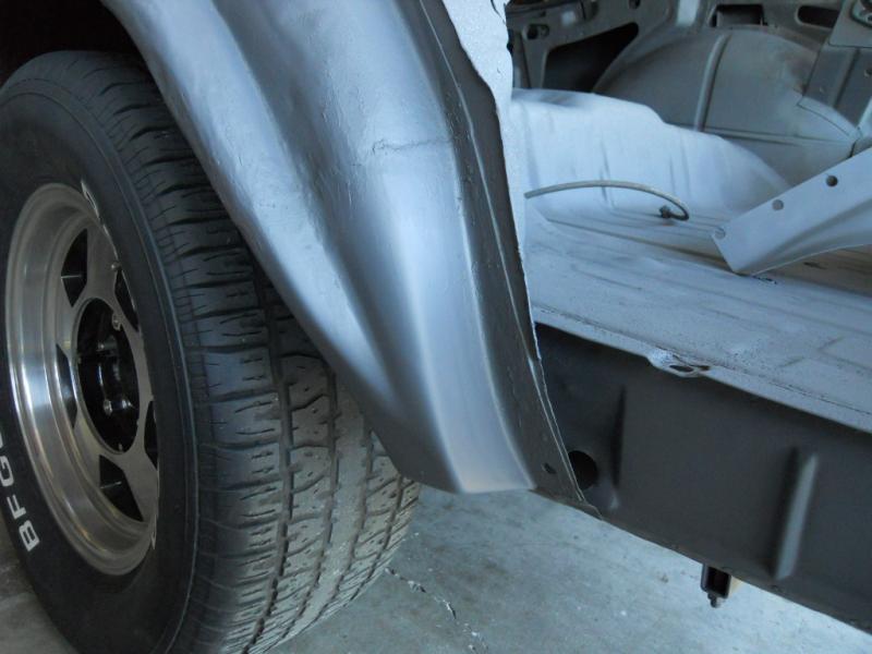

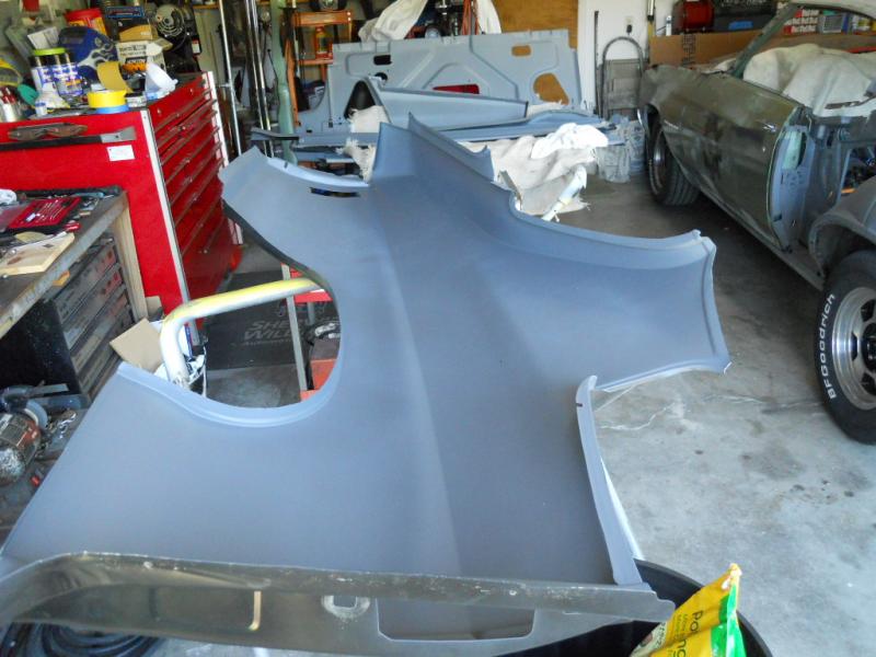

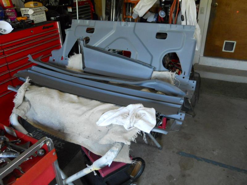

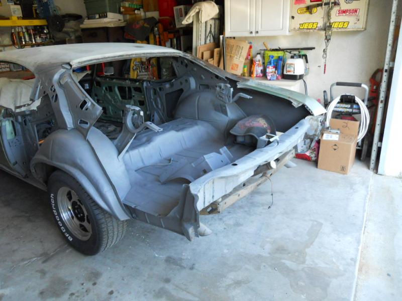

Fixed both my outer wheel housings at the rear..new metal.
Replacement panels scuff sanded with 220 grit and epoxy primed
Also shot the trunk and inner quarters.
Im starting to like the devilbiss finish line gun i picked up.
Next is punching a billion holes for plug welding....lucky me.
