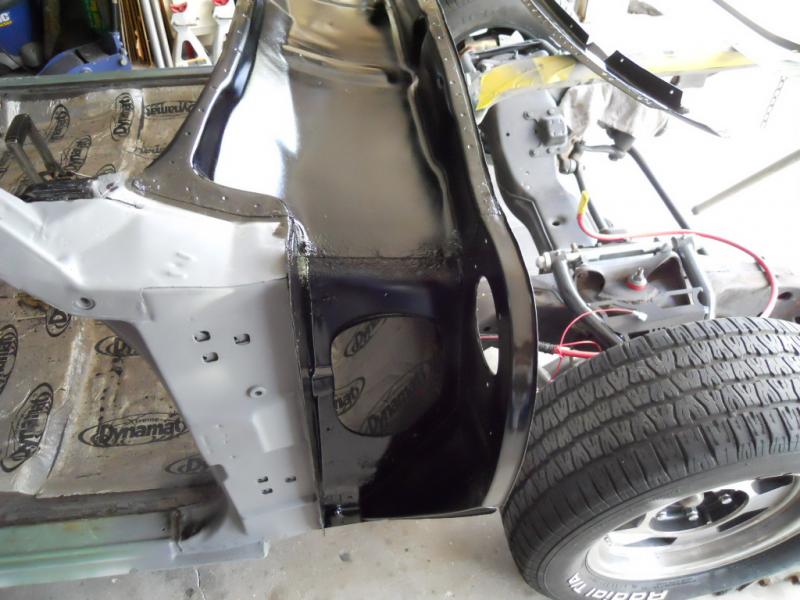

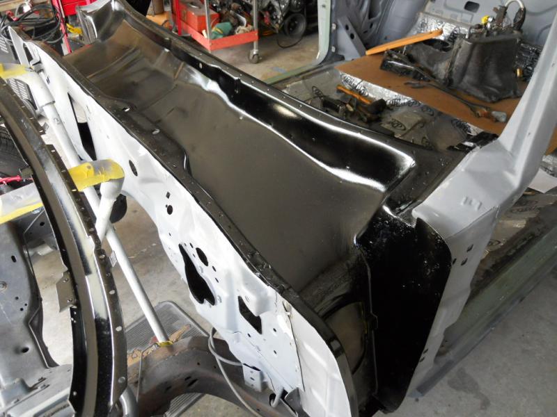

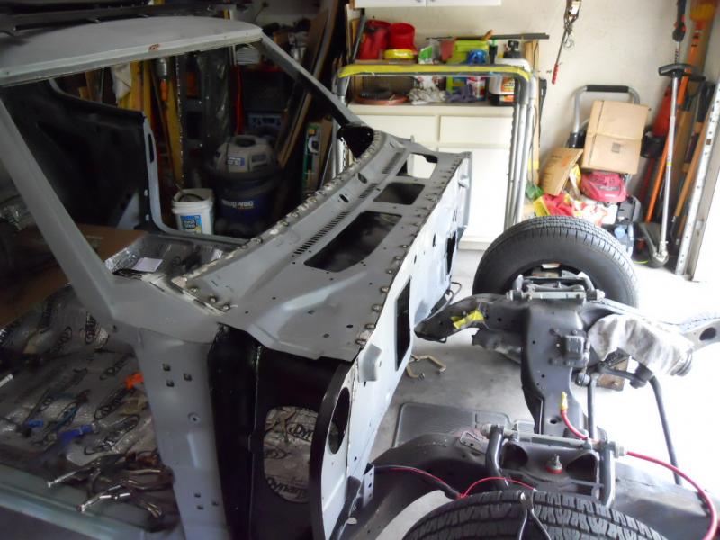

more progress today.

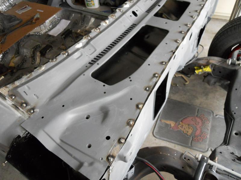

the lower part of the cowl is welded in and the upper welded on top of it.
Then i ran out of gas.
All parts have epoxy primer and single stage matrix paint on them

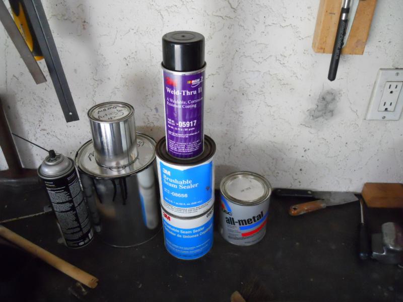

Where the plug welds are were taken to bare metal in each individual location
and hit with 3M weld thru primer.
3M brushable seam sealer is the next step before it gets the side pannels
