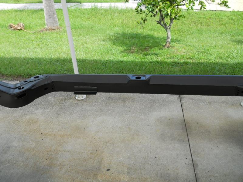

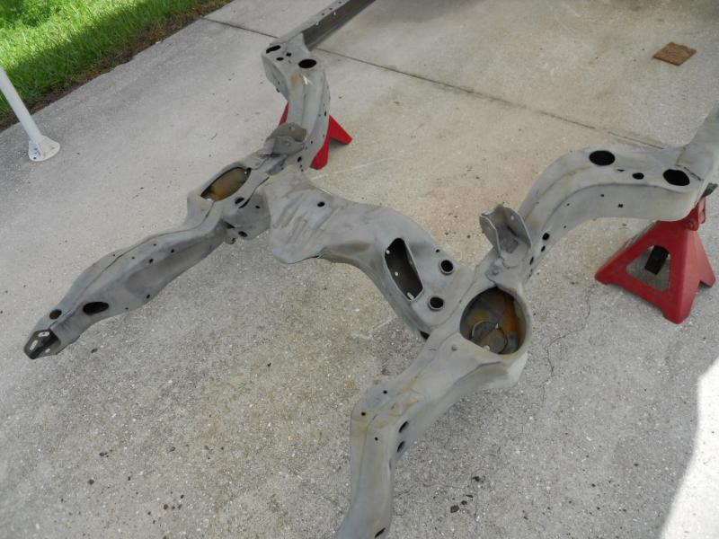

Frame came back from sand blasters.

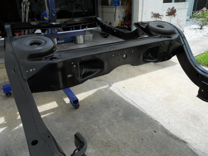

Gave it several coats of epoxy prime then boxed it with pre primed steel.
Then 3 cans of eastwood internal frame coat.
Then a few coats of eastwood 2k satin frame paint.

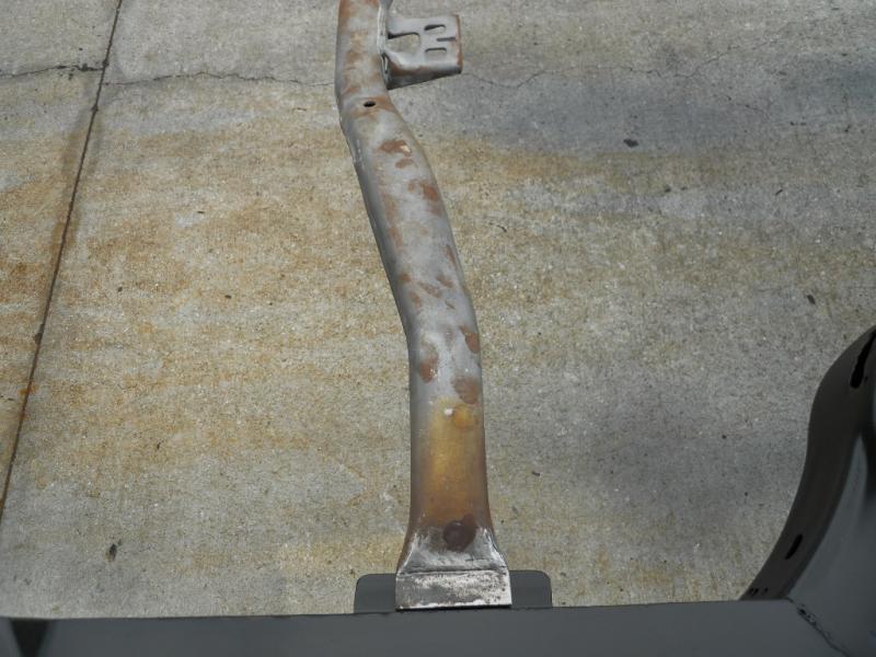

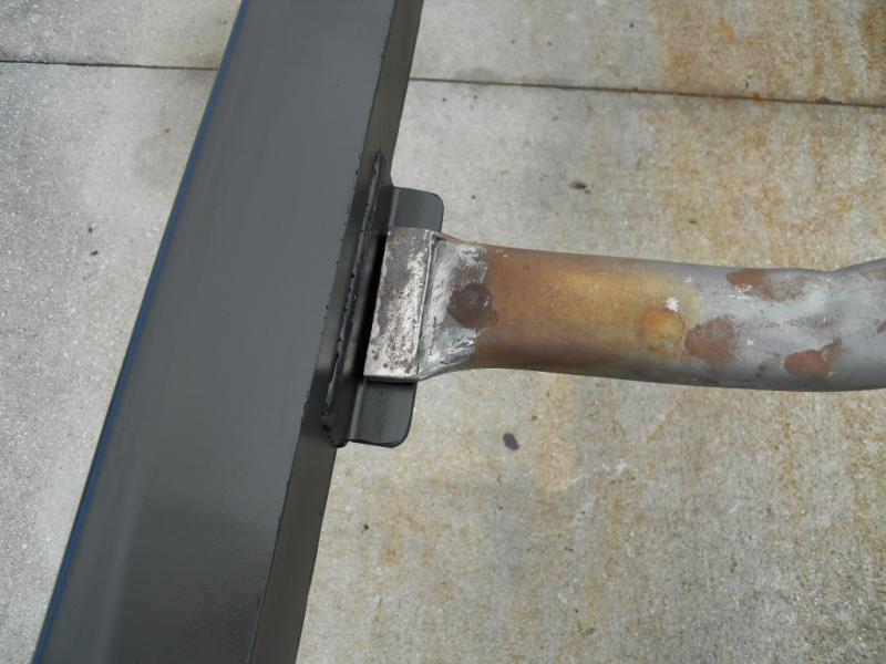

I modified the crossmember to work with the boxed frame.
