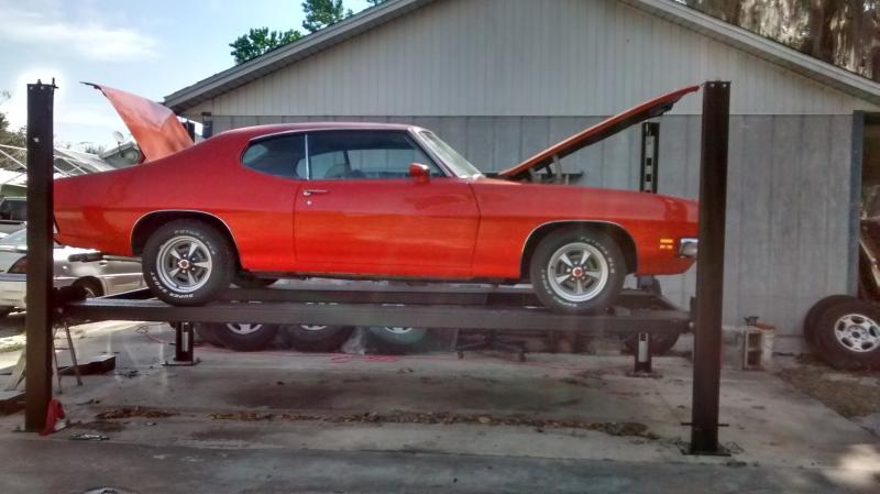

Day off, not really... worked on the LeMans. It starts better, the proper choke rod will do that. I think I have the lack of brakes narrowed down to a bad master cylinder. Also found that the distributor cap was loose. Lastly, removed the 3.07:1 geared 12 bolt rear and installed a 3.55:1 rear. It's getting closer, I just need the time to work on this stuff.
