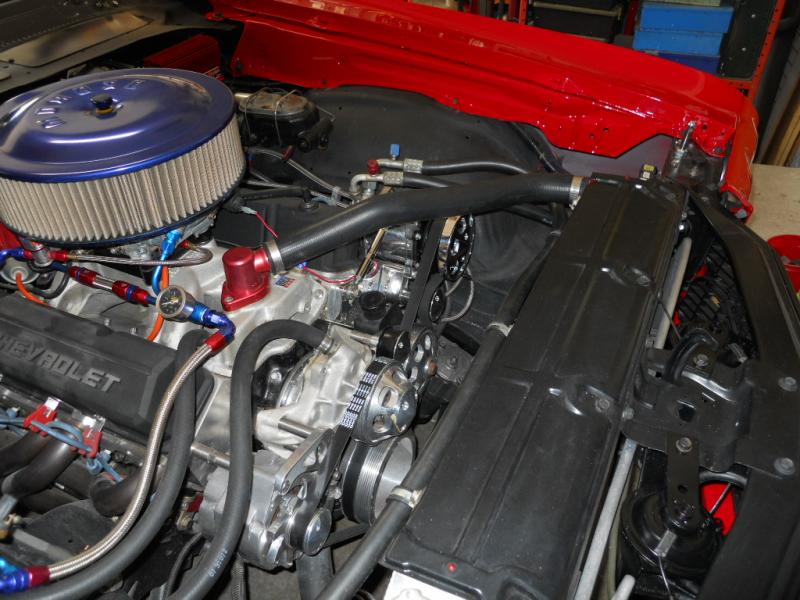

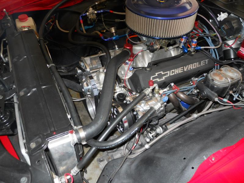

Got the ac up and running again.
Blows cold as a WT...lots of air movement.

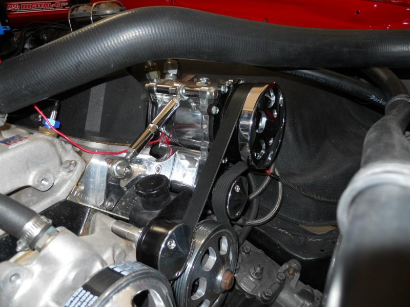

I had converted from v belt to serpentine.
So new compressor and pulley kit bolted right up.
An hour on the vacuum pump and 2 cans 134...cold.
Im running billet specialties brackets and pulleys....LOVE EM.
