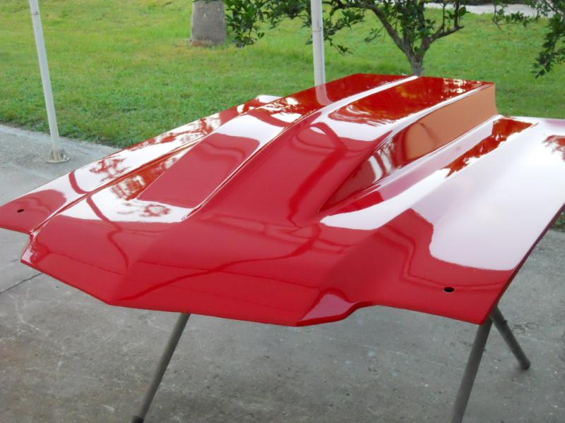

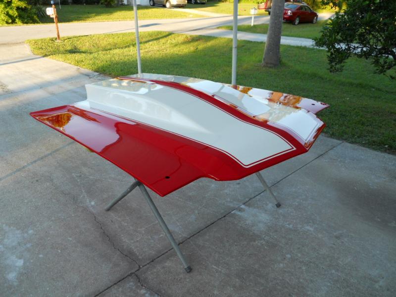

Hood was re test fitted then primed and blocked.
Then painted on the underside.
Flipped it over and did the top side then sanded 800 grit

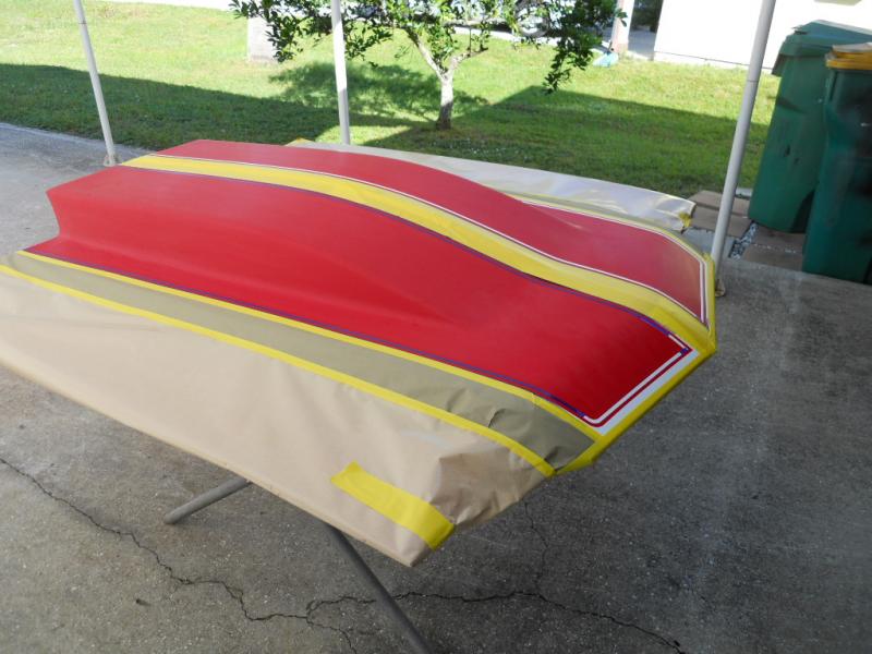

The stencil kit was a pain..but got laid and masked.
Shot the white base..then unmasked for 3 coats clear.
Cut and buff in a few days.

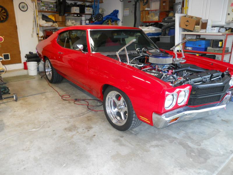

Next project is to replace the antenna wire..its not making contact.
Then the gages on the cowl need moved and lines rerouted.
Perhaps some wiper arms.
