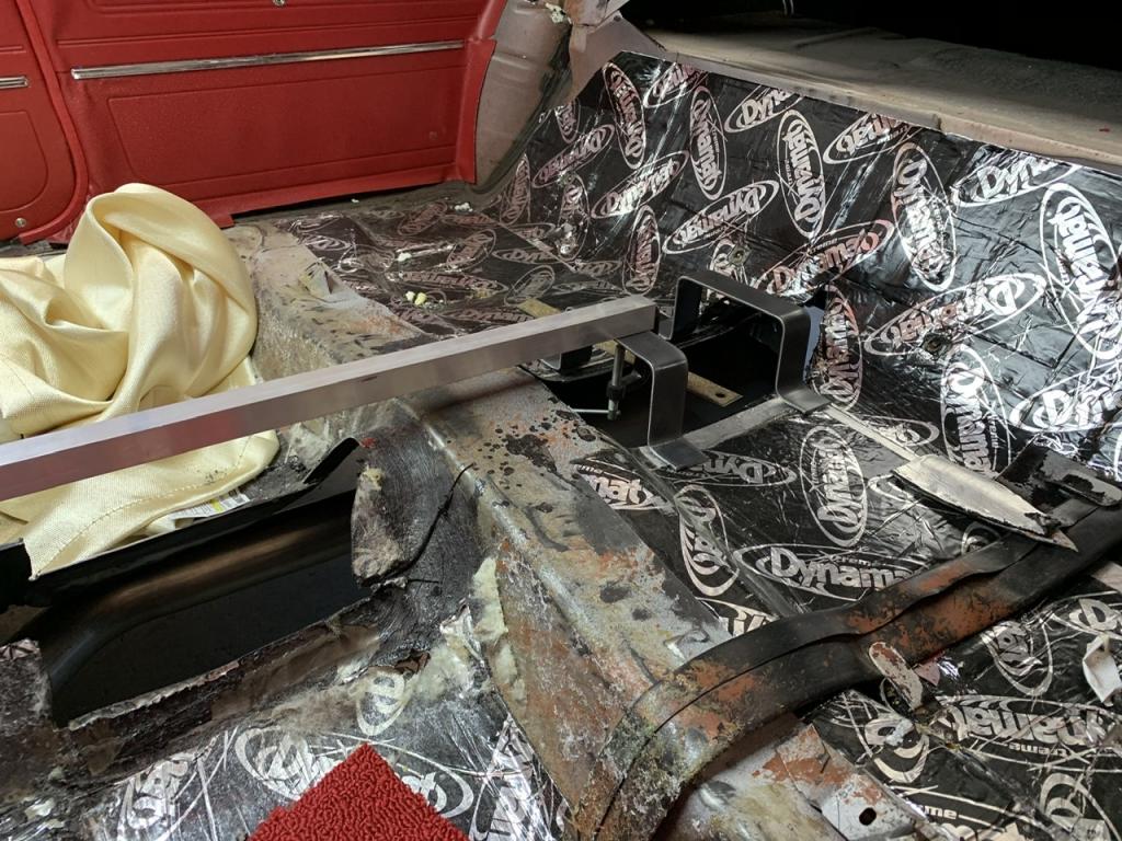

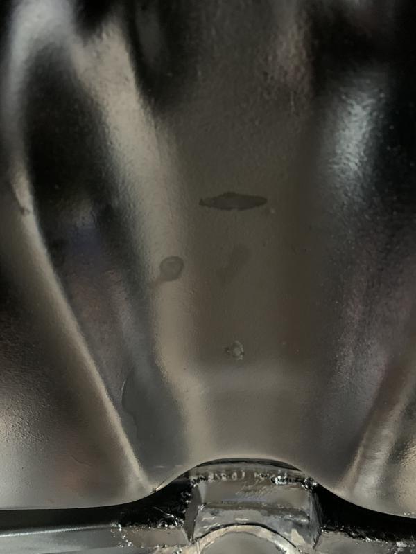

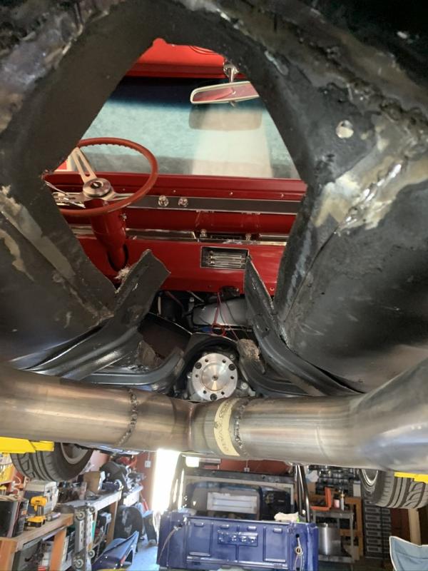

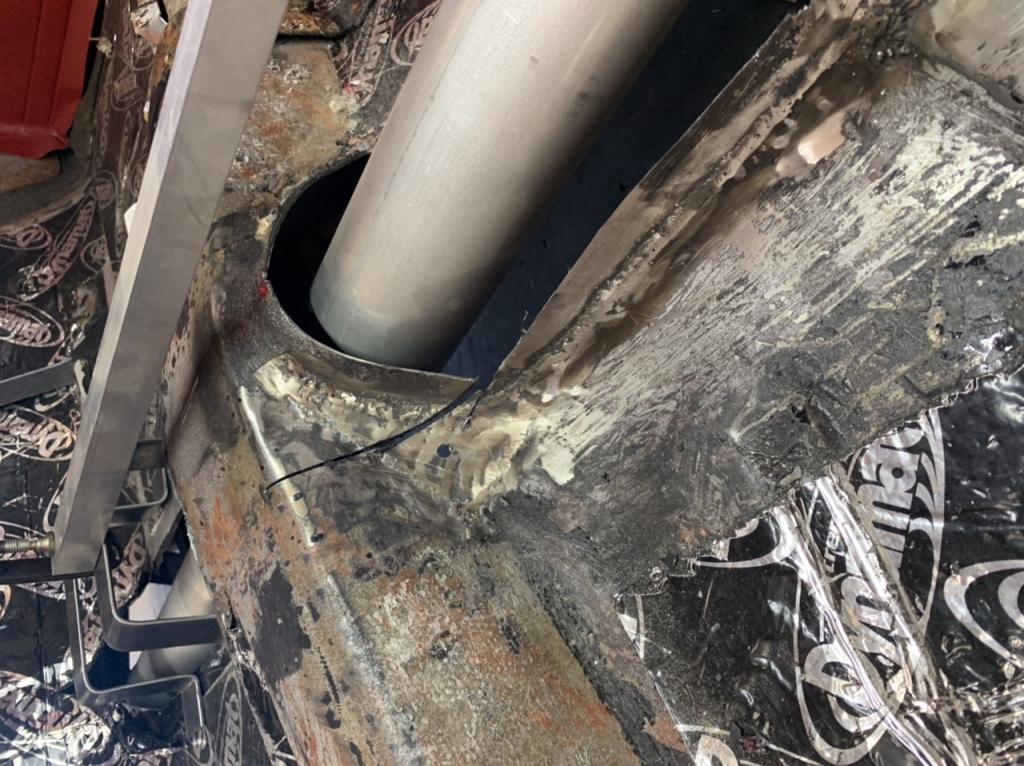

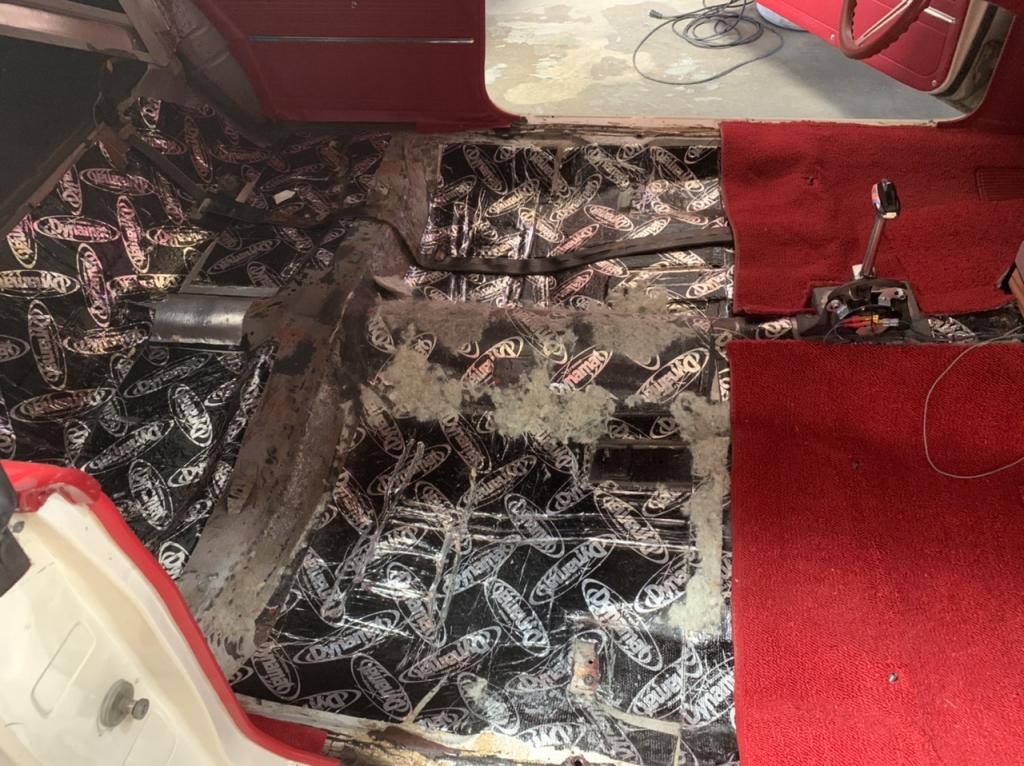

I’m in the middle of a project to enlarge my driveshaft tunnel because my driveshaft was rubbing the floor.
My car is low but not that low. But I set my engine/trans up a little higher in the chassis because they both have big, deep pans.
I had already enlarged the trans section so this really pissed me off that I missed this detail earlier.
Here are a few pics...
