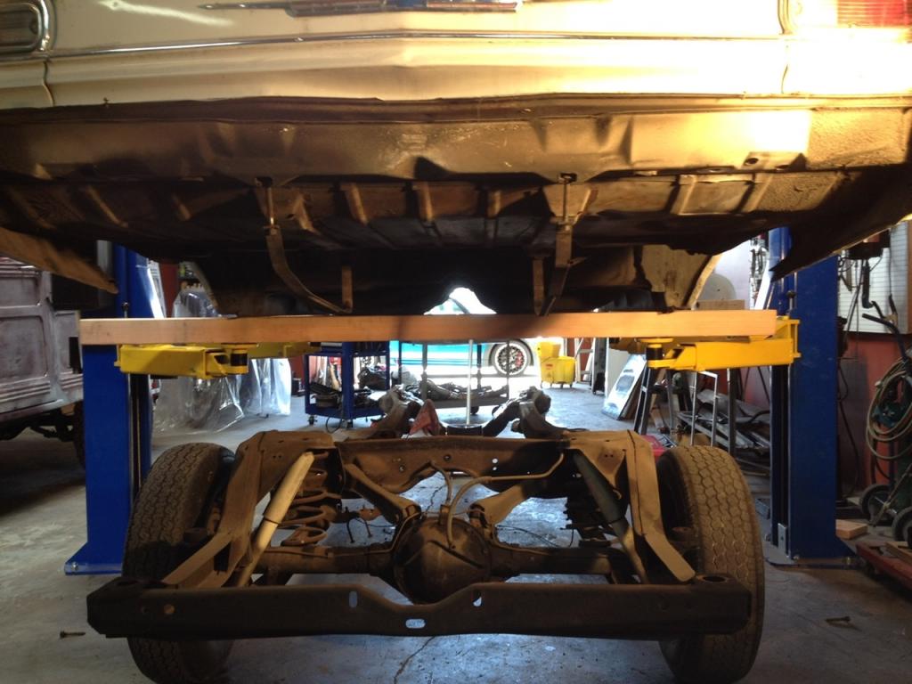

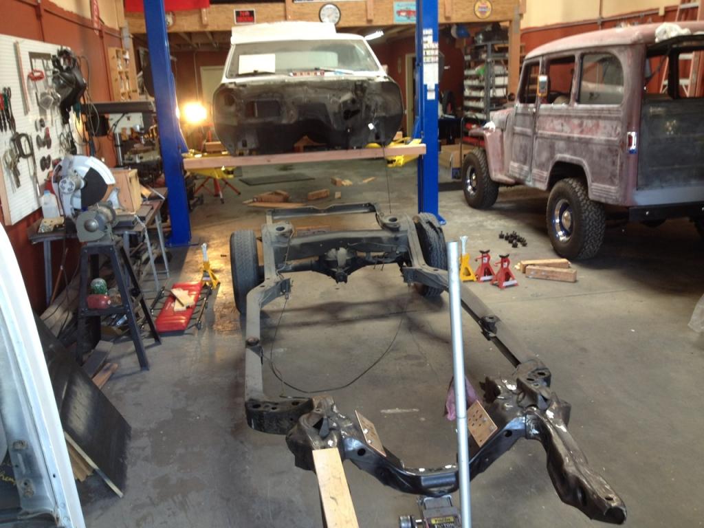

Once it was determined that the engine wasn’t going to slide in I decided to remove the body and do the entire chassis.

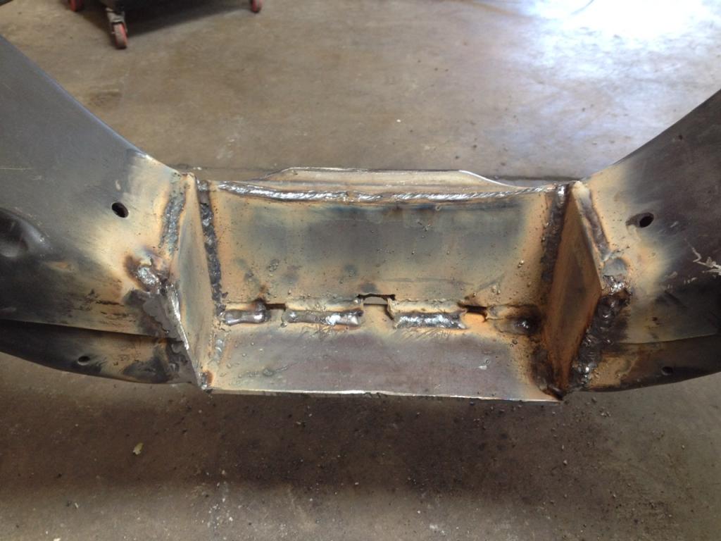

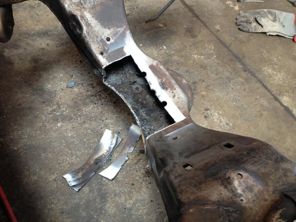

I ended up cutting and boxing the front crossmember to clear the oil pan.

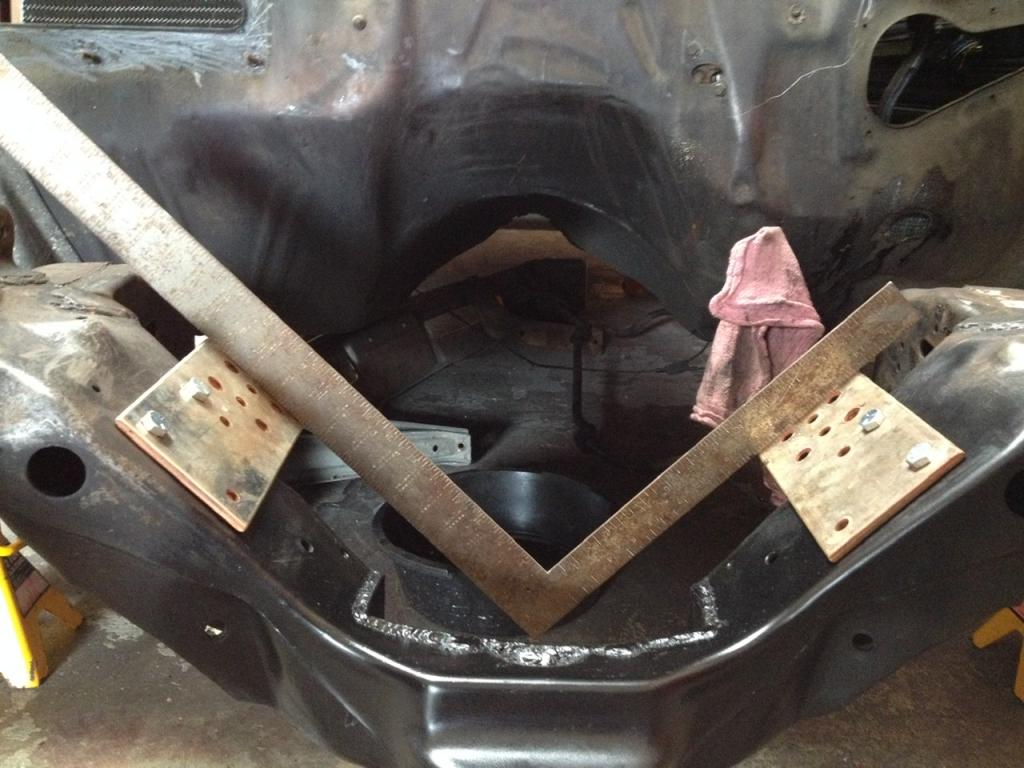

Then I had to build motor mounts. How many of you knew that the front crossmember mounting surfaces were 90 degrees from one another?
