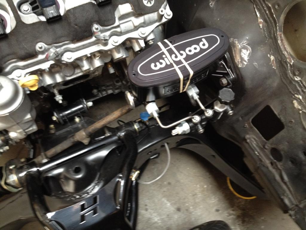

I used a Wilwood master for manual brakes.

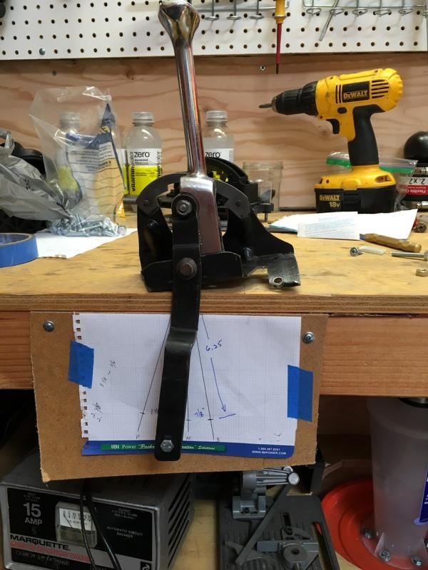

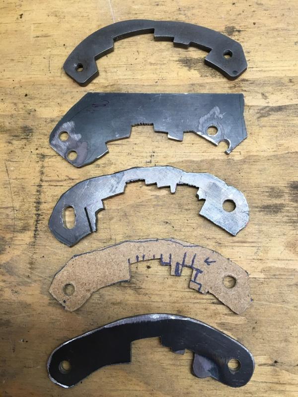

I wanted the stock Powerglide shifter so I had to make a new detent plate that matched the required throw of the 6L50e transmission.

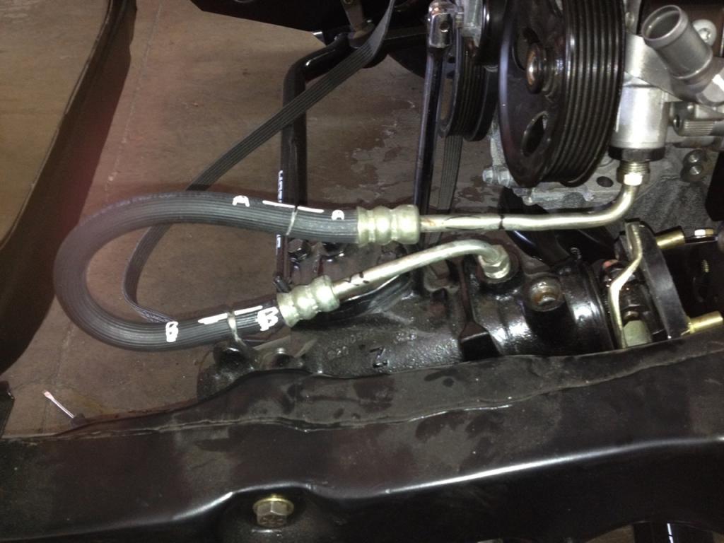

Mock up of a power steering line.
