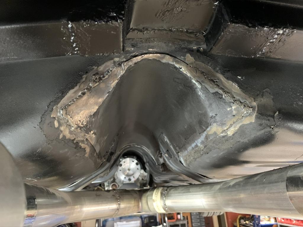

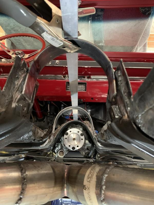

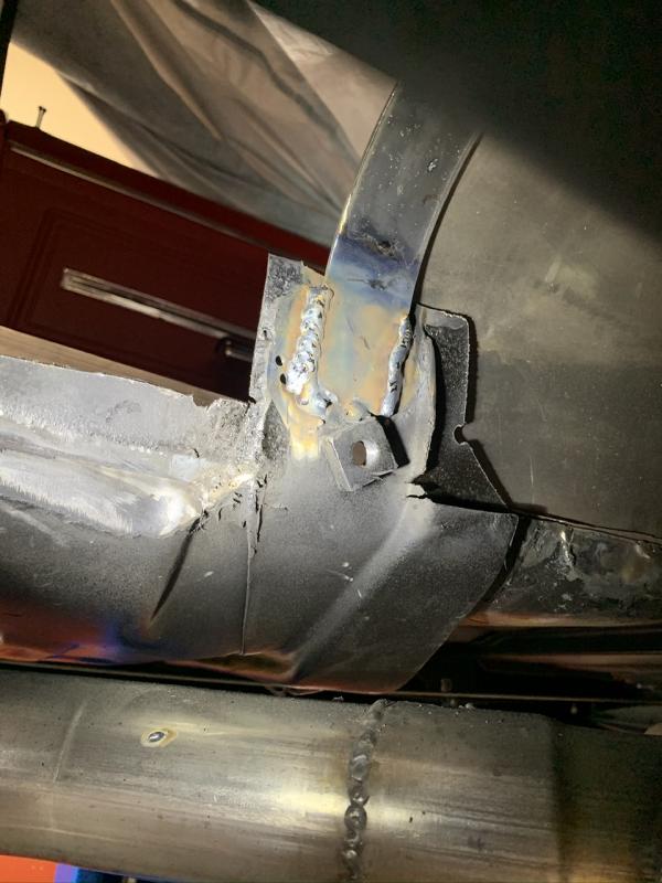

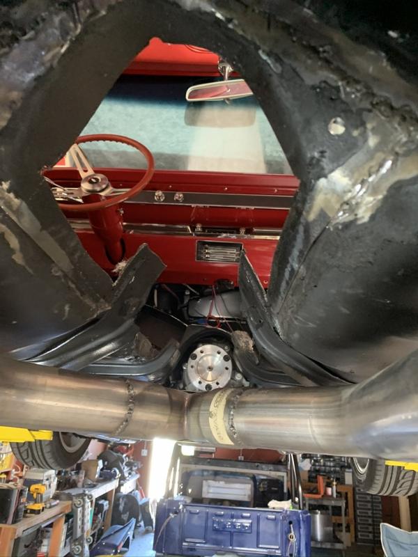

So after driving a few thousand miles and lowering the car a little more, the driveshaft rubbed the floor when carrying a passenger. I had already enlarged the trans tunnel and the forward part of the driveshaft tunnel but didn’t go back far enough.
So I’ve gutted the interior again and cut the floor out from the trans output flange all the way back to where it kicks up to the trunk.
