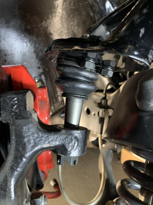

I have Hotchkis upper and lower control arms on my 66 but was still getting positive camber. It was suggested that I try taller upper ball joints. The greater distance between the two (upper and lower) ball joint pivot points changes the geometry and results in (theoretically) the camber going negative on compression.

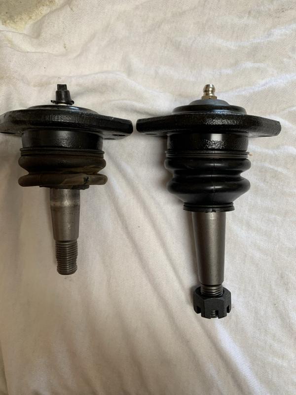

First pic is the stock and 0.9” taller ball joint side by side.

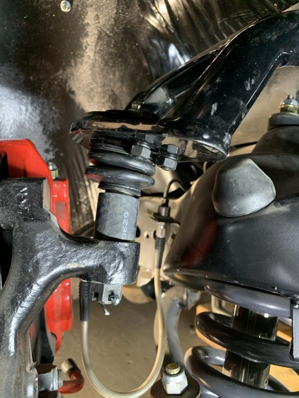

Second pic is the new ball joint installer.
Third pic is the taller ball joint with a short piece of heater hose around the exposed shaft to hopefully protect it. I’ll cram grease inside of it if I can.
So far the static camber seems to be better. I haven’t driven it yet but I did have a fat friend sit on the front fender and it appears the camber is now going negative (top in) on compression which is what these A bodies need.
