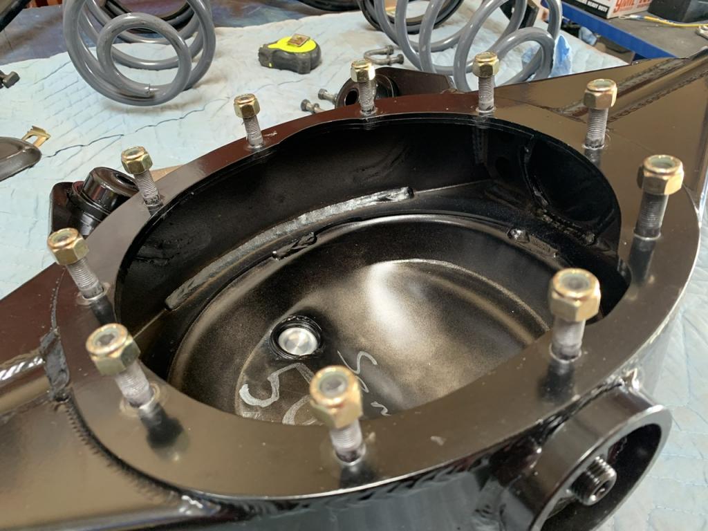

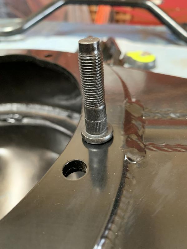

I had to put all of the studs in the housing. They’re knurled and I just used a nut and some washers to seat them.

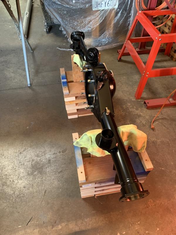

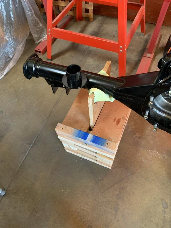

Then I cut half circles in the ends of a couple pieces of plywood so I could use the same wooden blocks to hold the rear end while I assembled it.
