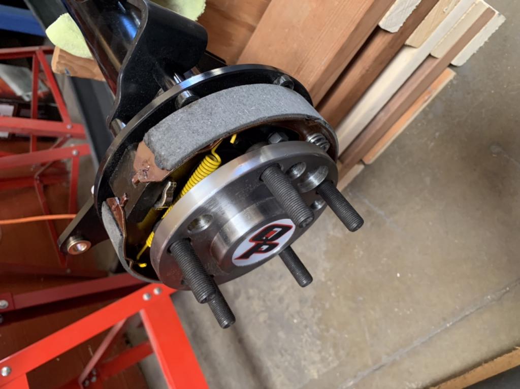

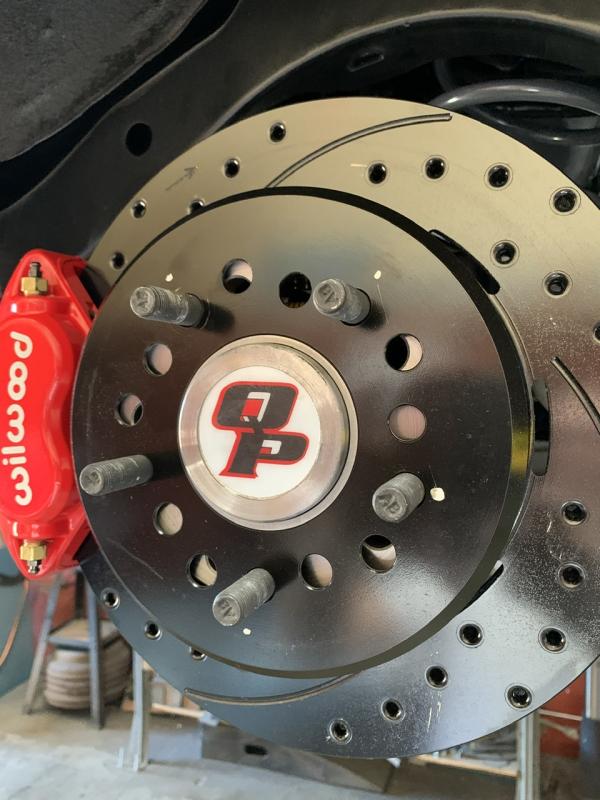

Next come the brakes. I couldn’t use the discs from the old 10 bolt so new discs came with the rear end. Ford uses a much better axle retention system than GM. The brake shoes are for the parking brake and are inside the disc hub. Axle goes in first then the disc then the caliper.
