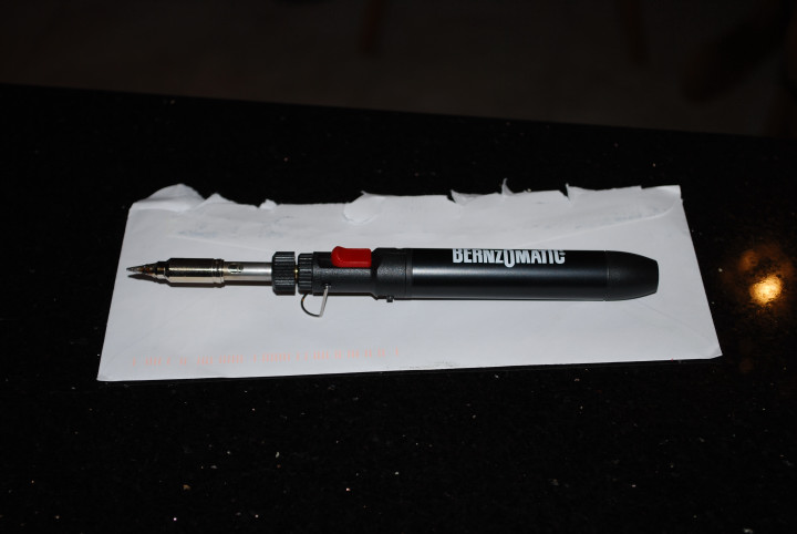

Honestly, for automotive wiring, 10g to 18g, I would buy one of these BernzOMatic's. No cord to drag around so you can get into tight places easily. Heats up quickly, right amount of heat.
Here is a picture of it sitting on a business size envelope which is a little over 8.5" long.
