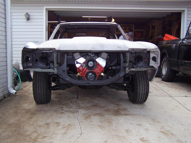

Default Here is the engine were building for our 72
Here is the specs on the motor *edited* its now back in he car.
69 block .060 over.
TRW LF2304F
Cast crank and rods balanced
Dart 11221111P 72 cc heads with 180 runners
Fel pro permator 7733PT2 head gaskets
1.45 springs
Comp cams hyd roller 294/300 .242/.248 .540/ .562 110 deg lobe.
Comp roller ultra pro magnum roller rockers 1.52
Pro magnum push rods
Dart sportsman II dual plane intake
Holley 770 street avenger
Hooker comp headers 2451 full length
Flowmater 2 1/2 American thunder exhaust and series 40 mufflers
MSD HEI
MSD 6AL2
Trans is a TH350 with shift kit and Hughes 3200 stall going to a 10 bolt with and eaton posi and 3.73 gears. Rear 1" sway bar. Tires are 275/60/15 TA's on the street and the same size TA drag radials for the strip. UMI tube upper and lower control arms frame braces. The car will be stock weight but currently working on lower its stance and firming up the suspension.
