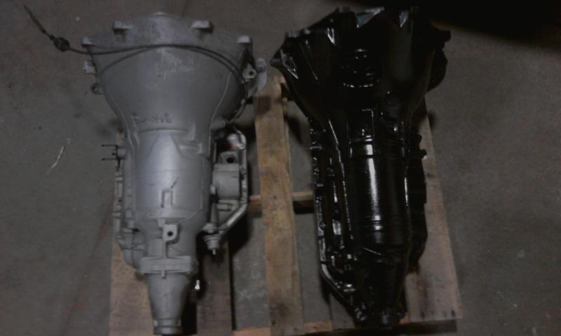

I probably shouldn't say this but, it should swap nicely.
(Sorry about the pics, they are from my phone)
The 200 4R (right) certainly looks beefier than the th350 that we are taking out.

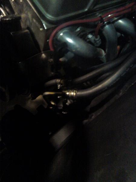

The HydraBoost is finally complete. Had to find a local place to make the hoses. Looks like they did a pretty good job.
Just had to put a spacer behind the Power Steering pump so that the hoses fit correctly with how we wanted the hoses to fit.

Cool! What brand of hydroboost did you use? Did it require any mods to the firewall for mounting it? The one I got looks like I need to modify the firewall, and I didn't get any instructions with it.
