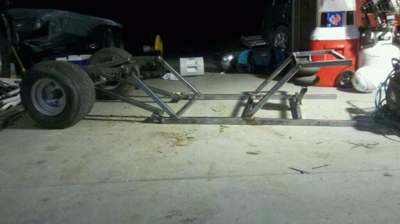

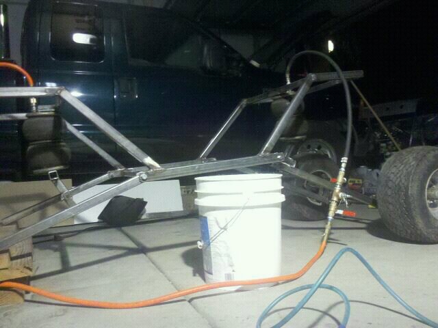

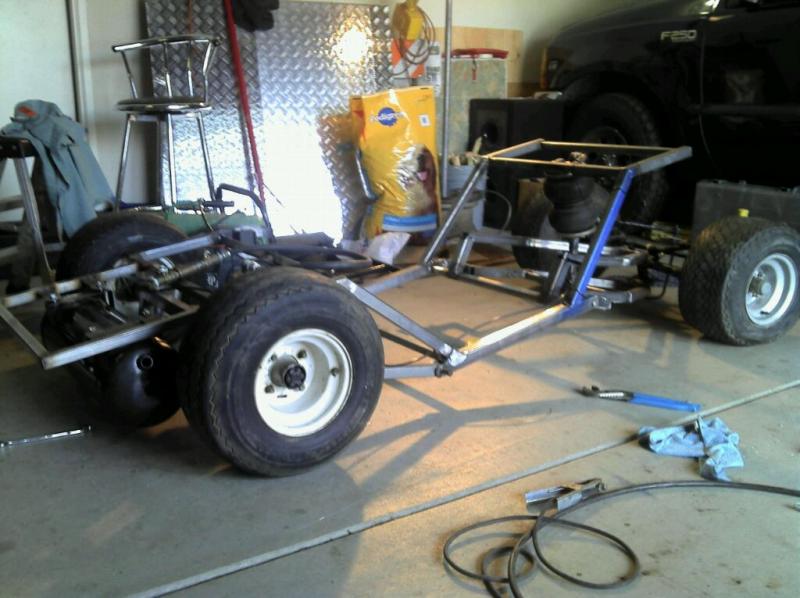

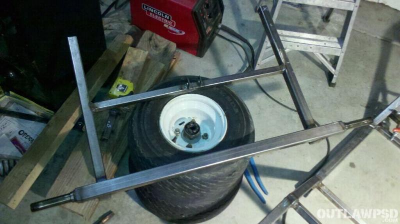

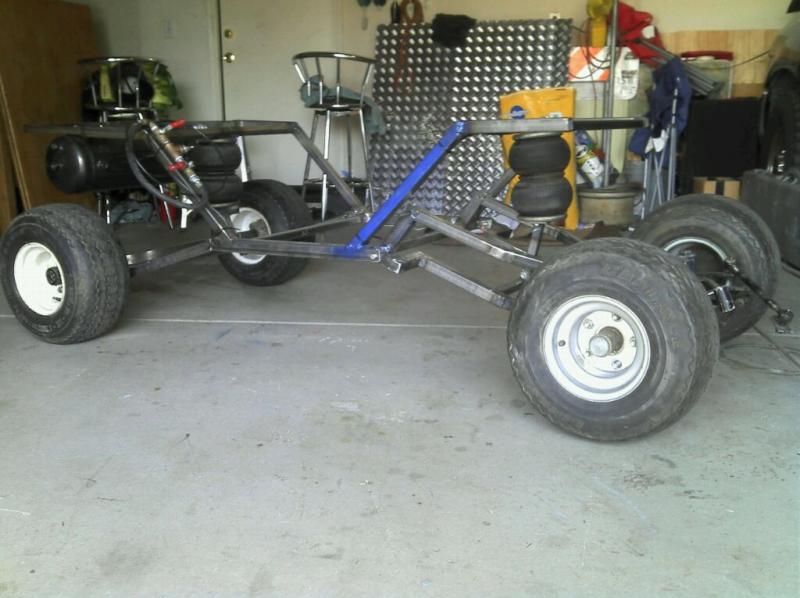

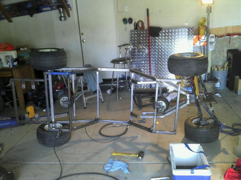

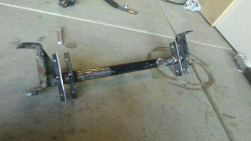

Well after finding out almost 5 months ago my wife is expecting again I decided I wanted a wagon for my kids but could not justify spending 500+ on some tricked out radio flyer so I decided to build my own. So after the last 4 months this is where im at.
Its just over 8 feet long, golf cart wheels and tires, 4 linked front axel to keep it so I don't have to fight the steering at what ever angle its at, 4 gallon air tank, 2 ply conitech air bags, 2 cooler racks and im in the process of getting an electric wheel chair so I can use the motor on this thing cause its about 70 pounds. Rolling this thing on flat ground is no problem because of the golf cart rolling gear but up/ down hill oh hell no.
